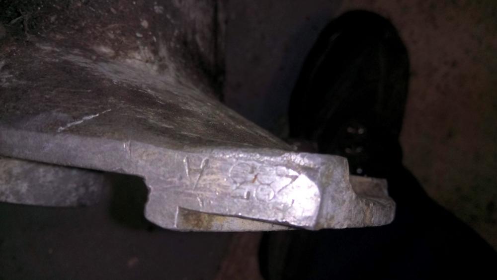

The number on the gearbox top is 7465D. I don’t  think that this is the original one though. Car no is A5-3148, chassis 47297, engine 47616. Body number on the tunnel is 39084. Date on diff is 25/10/27.
Parazine's hypothesis still supported, as 7465D would translate to 47465, which would be the right range for the car. Why do you suspect unoriginal though?

I purchased the car mid to late 1960s and while it was complete I can’t vouch for originality of the gearbox. Looking at it from a different perspective the 3 speed boxes are pretty robust so it could well be the original.
The number on the gearbox top is easy to read. Early gearbox cases had the number stamped on the near side web of the bell housing, under the starter housing, where it tends to get obliterated if the starter has been moving about. Later boxes, the number is stamped on the casing above the third motion shaft. I don't know when they changed the location....
This one is an early, XL part numbered box, 1924/25ish?
