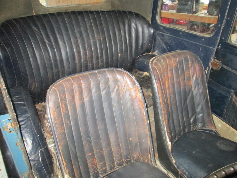

 Despite the state the rear seat still retains somewhat plush look cf earlier models.
