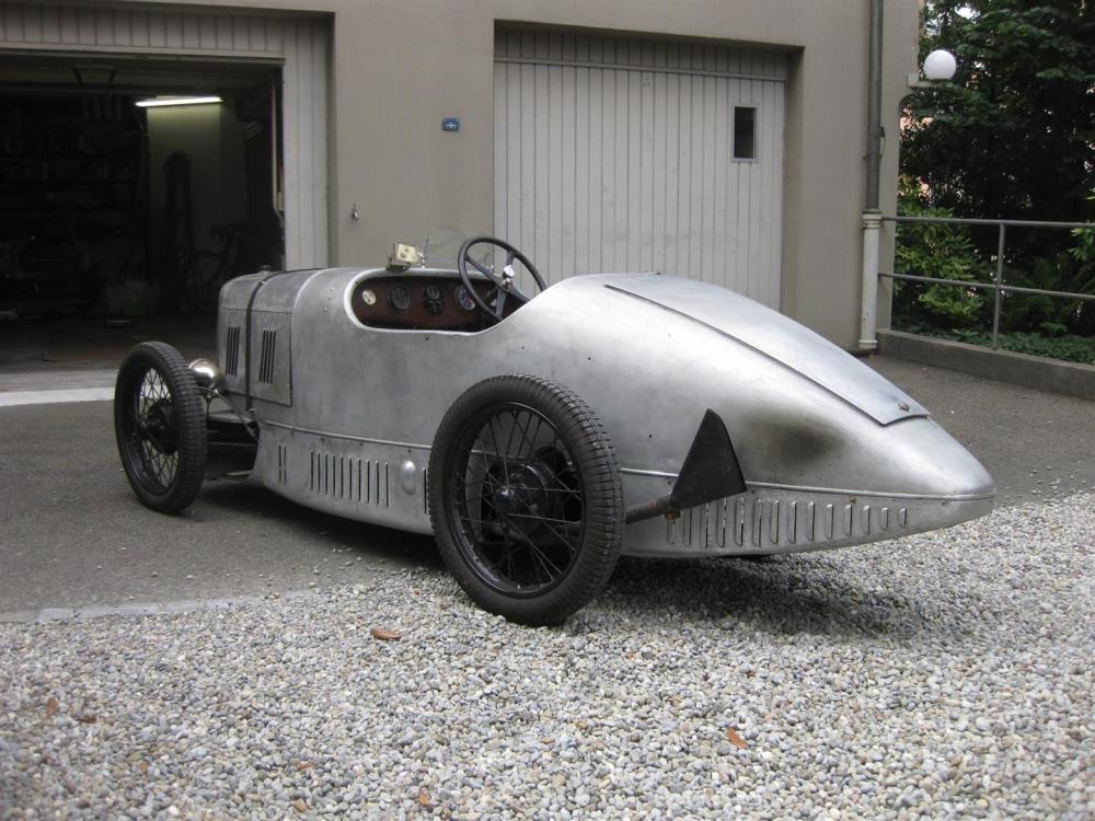

Is there a best way to remove cellulose paint from an aluminium body without damaging the aluminium also for the people that run a seven with an aluminium body ,how do you look after the aluminium ? wax ? polish ? oil ?

Most I imagine would suggest old stock Nitromors paint remover using a wood scraper made from a kitchen spatula to save damaging the ally.
The risk is how much damage and filler you run into along the way, which is why I would carefully take the paint back with a DA sander...a long, dusty and laborious job, particularly around any swage lines and mouldings.
I bet you ten bob that half way through the job you’ll say “sod it, let’s paint it!”
Good luck!

Hi Paul,
Back in the sixties ( yes, I know I shouldn’t be able to remember) I ran a Cambridge special with unpainted aluminum body. I used Solvol Autosol out of a tube. I gave it a polish every few months as it seemed like sweeping autumn leaves to do more often. It came off black on the cloth so obviously contained a mildly abrasive element to remove the oxide. Did look good but after a couple of weeks went back to informal.
So once you’ve got the paint off and havnt discovered too much filler you have a choice — if you want to keep it in plain ally perhaps using a good wax based polish would help keep the shine.

I used a block of aluminium with a sharpened edge to the 90 degree edge - probably about 7 or 8mm thick.
This had enough heft to act as a heavy scraper, (almost like a snow plough) leaving the surface perfect. You have to keep sharpening the block edge though.

Do be sure to avoid anything with caustic soda which will attack the surface of the ali. Give a scratch finish with dark grey coarse Scotchbrite and finish with light grey fine Scotchbrite.
Twice a year I wash and dry and then final do with light grey Scotchbrite. Spray with SAS maintenance fluid and wipe down with dry paper towel pads.
