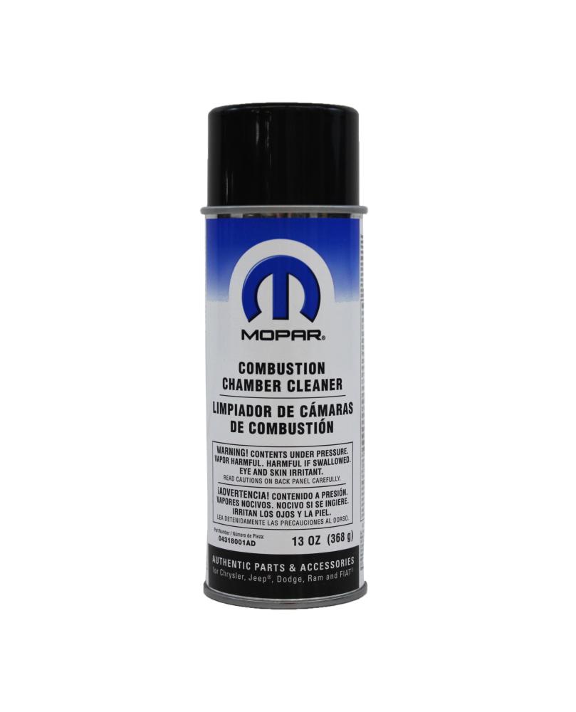

Three months is more than long enough for ethanol to take hold. (I presume you have the same fuel blight on your side of the pond) A Little carb cleaner in the carb itself might help as well. A few years ago my mechanic gave me a can of Mopar carb cleaner to run through the engine (while it was running) It transformed the car. He was telling me tales of the Chrysler K car engines coming in that were barely running and a can of this cleaner restored the running with literally no other tuneup.
