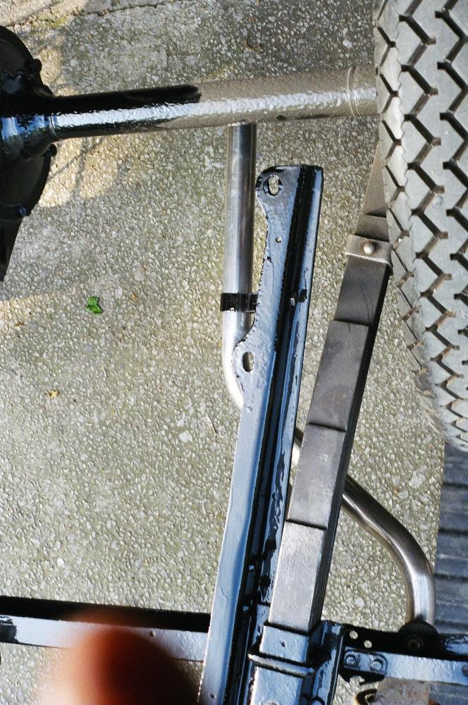

I've got another question about the exhaust down pipe, according the the various parts books the exhaust system is the same as on earlier cars passing through the chassis cross member with only a short tailpipe exiting in front of the rear wheel. Am I right in thinking this changed in the later cars with 4 speed crash boxes, the down pipe going below the cross member and a long tail pipe right to the rear?

RE: RN Box rebuild questions - Dave Mann - 28-11-2024
The 3 speed RN exhaust pipe passes through the hole in the NS end of the chassis front cross member      whilst the 4 speed exhaust passes under the end of the cross member for which the combined exhaust manifold flange orientation changed. The 3 speed tailpipe ends just behind and below the rear axle          whilst the 4 speed passes over the rear axle.
