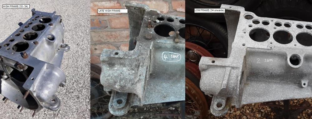

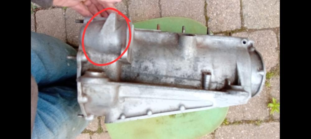

RE: Chummy engine swap - Nick Lettington - 23-11-2024
I believe* the high frame version has no reinforcing rib behind the starter motor.
The Ruby version has a rib as pictured here...
*credit Ruairidhpedia
RE: Chummy engine swap - Chris KC - 23-11-2024
With apologies to whoever took these photos (found on the web) :
