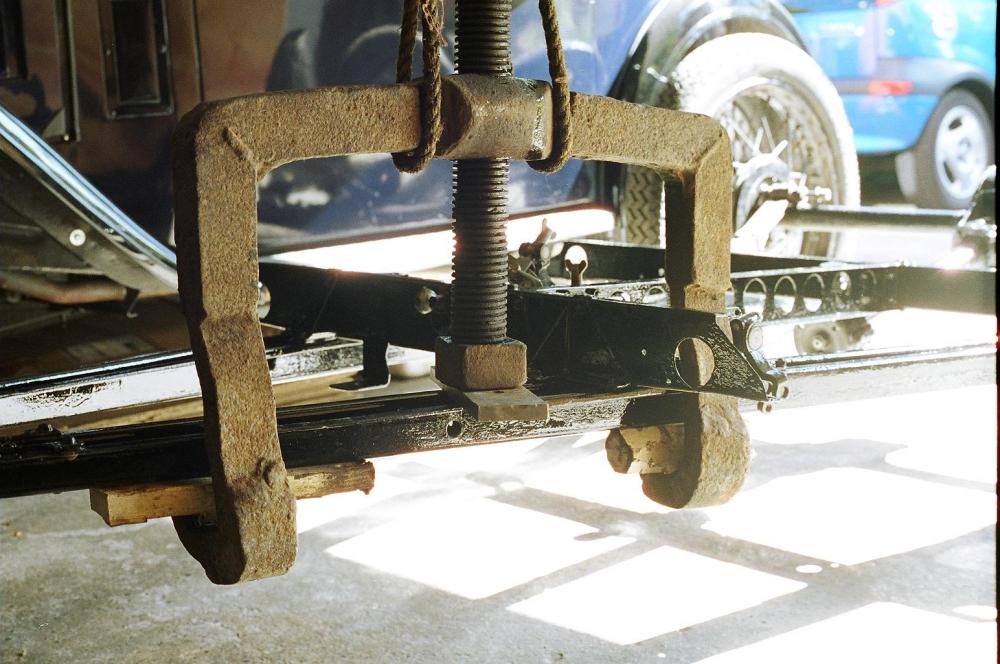

RE: Steering box advice - Dave Mann - 14-11-2024
I was always surprised that on one of our Sevens fitting of the front axle was a bit of a fight, all was revealed during it's rebuild the OS chassis rail was bent which was obvious when the body was off. It was straightened using a borrowed rail cramp from a local railway preservation society and easily done and checked with the body off.
RE: Steering box advice - Reckless Rat - 14-11-2024
Nice one, Dave. The railway approach is never subtle, but effective.
