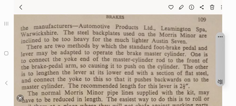

Brake Pedal ratio. - Mike Morley - 22-10-2024 I'm fitting Morris Minor 7" brakes to my Austin Seven Special. As I understand it, the Morris has a 13/16" diameter master cylinder. Can anyone with a similar set-up please let me know what the correct pedal ratio is? Also, are there any modern type track rod ends available that will fit the Austin drag link in place of the original type? i.e. with the same taper. Thank you. RE: Brake Pedal ratio. - Nick Lettington - 23-10-2024 Hi Mike. Small ford spares sell the ford ones most commonly used on Austin Seven specials. There are others so probably easiest if you post a picture. On the brake ratio there's a post on here somewhere I think with a photo of the instructions that came with one make of hydraulic brake kit. I think that gives the distance required for the lug for the push rod. Lots of info here, but you probably need a page from Williams specials book. https://www.austinsevenfriends.co.uk/forum/showthread.php?tid=791&highlight=Hydraulic It's more common to add a lug and put the cylinder in front of the pedal rather than as described here (you'll know why if you ever owned an A35). It would make sense for the distance up from the fulcrum should be the same.to maintain the same mechanical advantage. RE: Brake Pedal ratio. - Howard Wright - 23-10-2024 Hi Mike This thread may help? https://www.austinsevenfriends.co.uk/forum/showthread.php?tid=5014 Cheers Howard RE: Brake Pedal ratio. - Terrytuned - 23-10-2024 Use a 3/4" Girling master cyl and silicon brake fluid and you will not have problems with cyls seizing. Terry. RE: Brake Pedal ratio. - Mark Dymond - 23-10-2024 Specifically regarding pedal ratio, its important the master cylinder piston travel is not too short, you loose bit at the start and you dont want that to be significant amount of the total travel. Aim for the most travel that the master cylinder was designed for and pick a suitable diameter for the four slaves |
