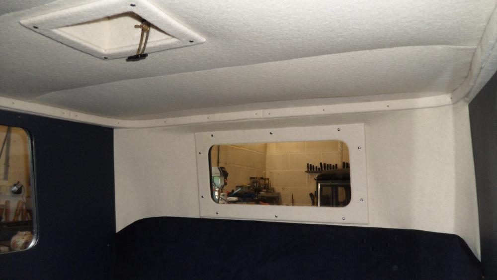

I did the Pytchley with a cream wool blanket that I picked up at a charity shop for 50p.   I don't think you can go far wrong with a cream or beige head-lining, to my mind they look more original than other colours.  The photo below taken with a flash makes the head-lining look to have a bluish tint, it is actually cream!
