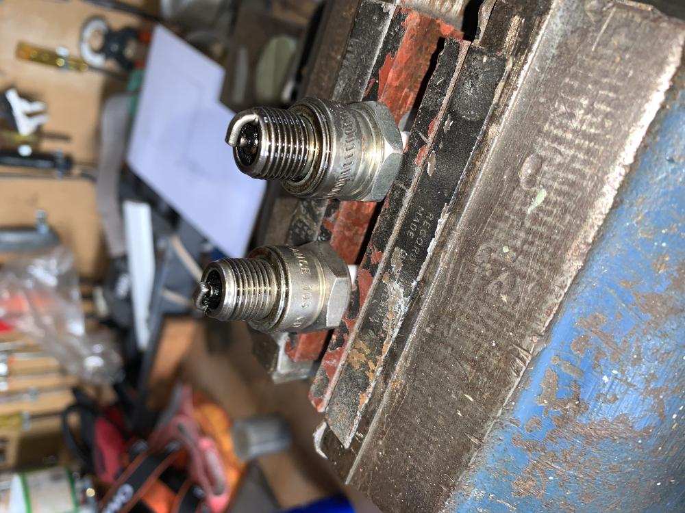

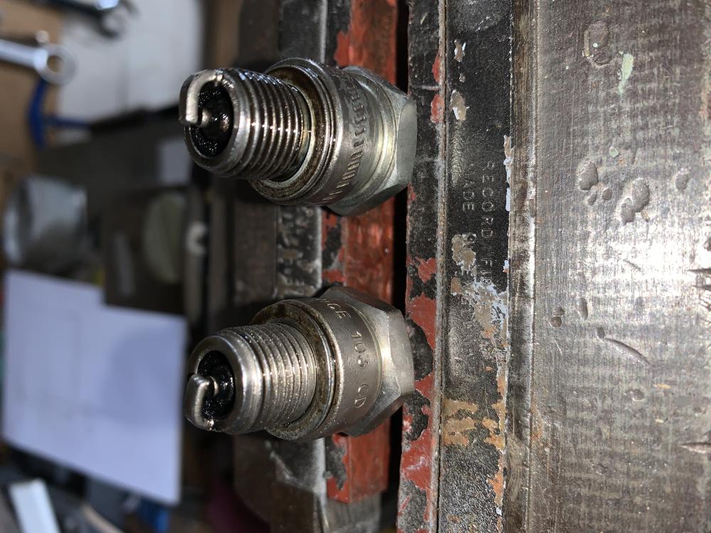

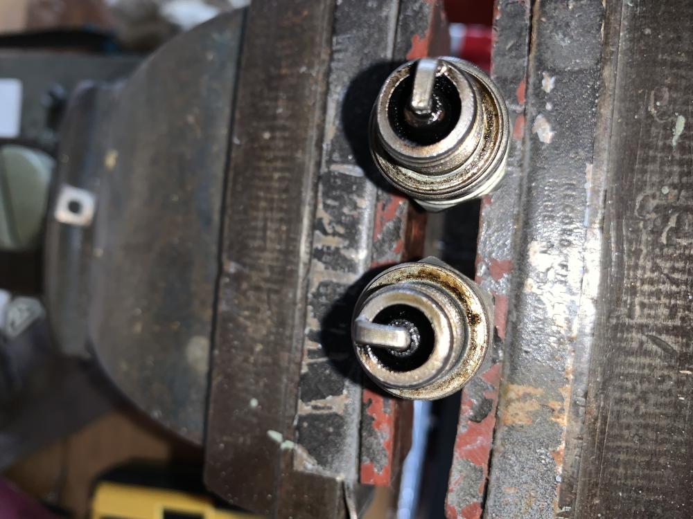

Here’s some pictures. Two different markings, different suppliers, but both very little use
There are 2 different Champion logos so they came from different suppliers I think.
Sorry, I double clicked, better too many than not enough?

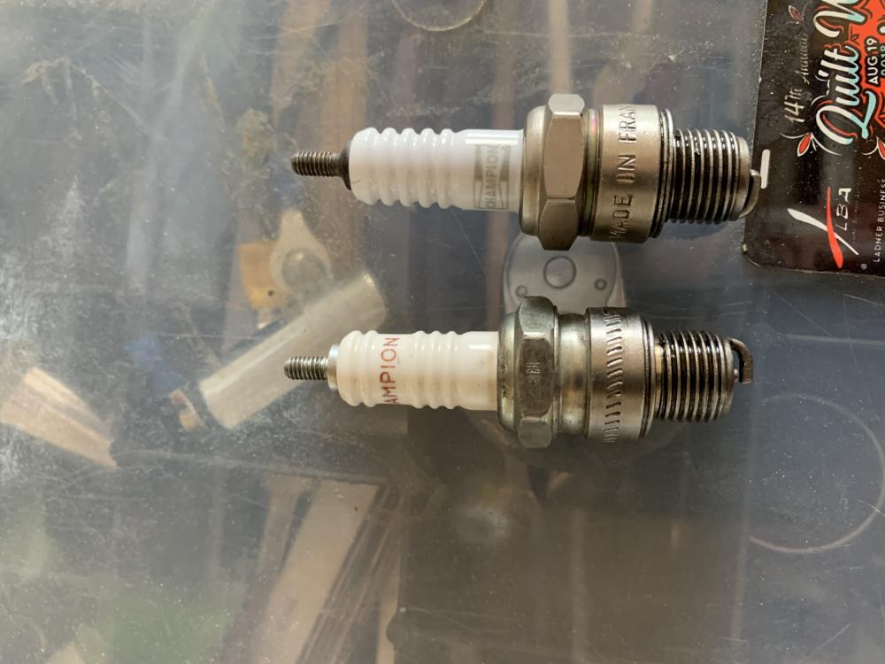

Here's the Champion box and plug that I received from the Green Spark Plug Company last Wednesday. They were out of stock of NGKs - I think they said that delivery was due early September - but suggested that this would be a close match. If Green Spark Plug Co. (who must order lots of plugs) has to wait months for delivery one must assume that they are the real deal. I hope this helps.

The plugs in your picture appear to be fouled.
Too rich a mixture or oil coming up the bore? Modern plugs do not have a shiny glaze on the inner ceramic part any more, once fouled you cannot clean it and the plug won’t work.
RE: Rapid plug failure in Chummy - PeterN - 28-07-2024
Thank you, I rather think it may be oil fouling but I’ll get some new and see how it goes.
