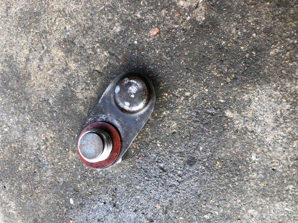

Still doing lots of checks, but last night decided to drain the gearbox. Took the drain plug out and ended up with both the plug and a piece of metal (see picture).
This morning jacked the car up higher and found TWO holes into the gearbox. One obviously is for the drain plug, the other I have no idea about, but it could explain why the underside of the car is coated in oil
The second hole does not have any signs of a thread cut into it
I cannot see how to make the second hole oil proof unless I resort to some drastic measures.
So oil change is on hold while I see if I can come up with a solution.
Anyone know of a 'fix' for this ?.
BTW the car is a 7 Tourer of 1933 vintage.
Martin.

It looks as if the unthreaded hole is a drain for any oil that finds its way into the clutch pit.
RE: Gearbox oil change - Colin Morgan - 18-02-2024
...and the 'bit of metal' that came with the plug is there to stop muck from getting into said clutch pit, but isn't supposed to seal.  Also, as can be seen in the picture, oil is more likely to be seeping from the sump nearby - and also from other places higher up on the engine such as the block to crankcase joint.  This is not unusual.
When refilling the gear box, it is  good idea to leave the oil level a bit below that specified by Austin originally - this helps it stay in the box and not end up on the clutch.  (I run my Ruby box at exactly 3/4" below the top gearbox face where the filler hole fits and that seems to work.  Various threads on here refer.)

Thanks both.
Managed to get further under the car (not good when you have Labirinthitus) and yes it goes into the belll housing.
Had me a bit confused at first as feeling in the hole with fingers I thought I could feel a gear, now know it was
the flywheel !!.
Will underfill the gearbox as recommended.
