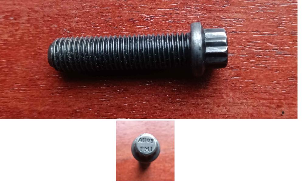

I'm assembling an engine with Phoenix 1 5/16" rods on a Phoenix crankshaft. The rods are metaled and the clamp screws or bolts look like this:
My instinct is to do them up to 30 ft/lbs with a drop of Loctite but does anyone have a definitive torque?
For what it's worth, the screws seem to be of North American origin, 5/16" UNF thread. One website has them listed with full specs but frustratingly, no tightening torque!
12 Point Flange Bolt Dimensions & Specs | AFT Fasteners
5/16"-24 x 1-1/4" 12 Point Flange Bolt | AFT Fasteners
AFT state that they're "made to Grade 9 specs". Comparing the figures, that's roughly equivalent to 12.9 metric spec; an M8 12.9 bolt would be 46.4 Nm or 34 ft/lbs.

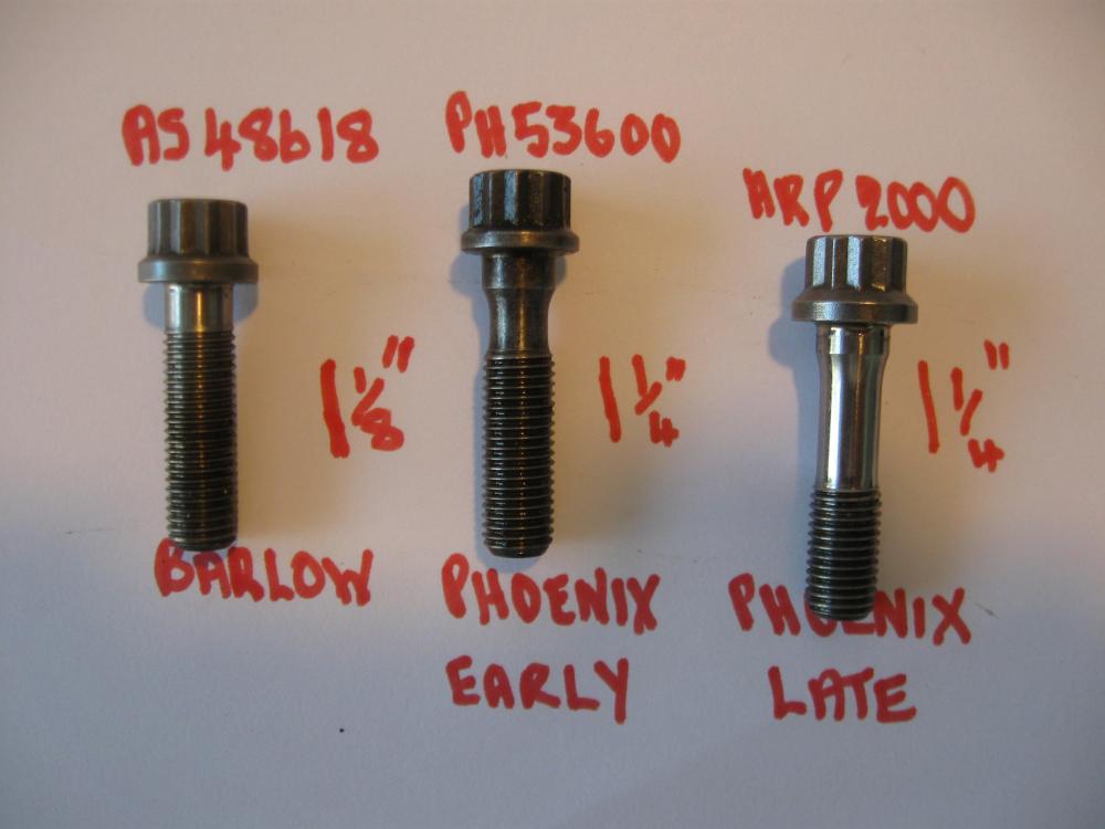

Photo of conrod bolts used early bolt torque was 30 ft/lbs ARP bolt torque 35 ft/lbs, no locktite. Terry.
RE: Phoenix rod bolts - Martin Baker - 20-01-2024
Out of interest, here is the website for ARP  bolts: https://arp-bolts.com/.
The advice I was given is that they should only be re-used 3-4 times and they are very expensive. Last time I spoke to Alex Myall he was using an even higher spec bolt which could be used a greater number of times but even more costly! Remember they are designed to stretch to maintain load. John Barlow's version is just a normal boilt which I would be nervous of using.

ARP rod bolts are correctly installed in elastic tension, so should be reusable.
If they’ve been over tightened, either by the use of a rubbish torque wrench or someone who incorrectly believes they have a calibrated wrist, then they should be replaced.
The ARP website says:
Are ARP bolts and studs re-usable?
Yes. As long as the fasteners have been installed and torqued correctly, and show no visible signs of damage, they can be re-used. If they show any signs of thread galling or corrosion, they should be replaced. In the case of rod bolts, if any of them have taken a permanent set and have stretched by .001” or longer, you should replace them immediately.
