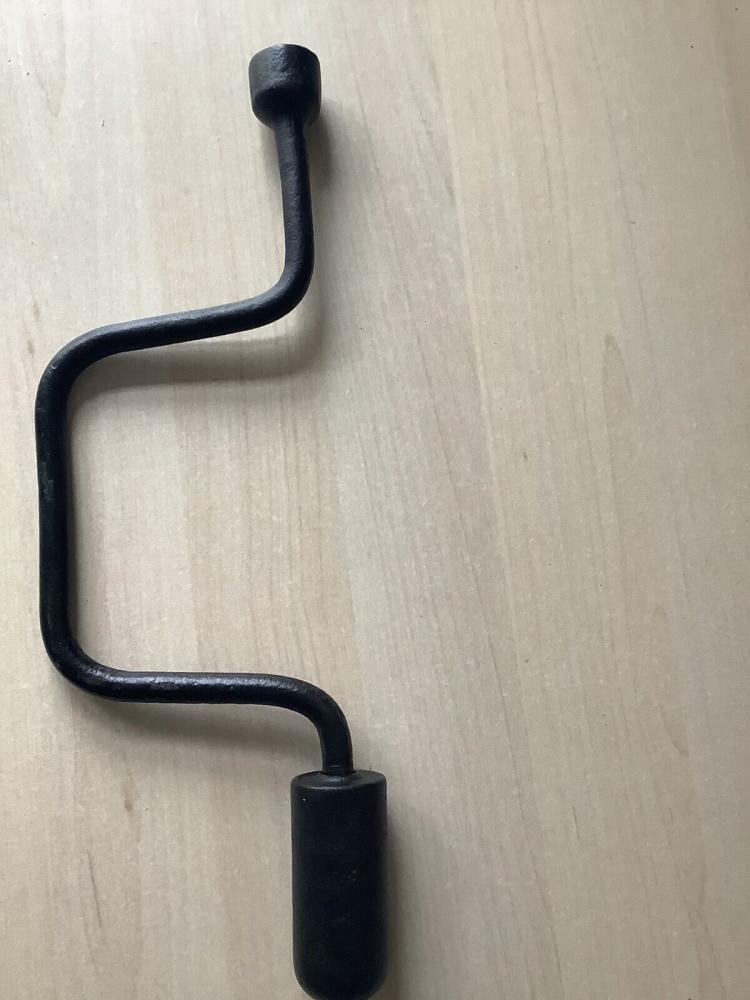

RE: Wheel nut size - k8207418 - 12-05-2023
Bought this item and it doesn’t fit
It measures about 18mm and the wheel nuts measure about 16mm?
RE: Wheel nut size - Reckless Rat - 12-05-2023
That's because it's for an Austin A30/35 and not an Austin 7.

RE: Wheel nut size - Tony Griffiths - 12-05-2023
The thread pitch might well be 3/8" BSF (British Standard Fine) but the size of the hexagon nut on an A30/A35 is larger than that on an A7. As John posted earlier, across the flats of the Austin 7 wheel nut is 19/32" - which is 0.59375 inches or 15.08125 mm. The best advice? Find and use a genuine A7 wheel brace - and check the nuts regularly.
