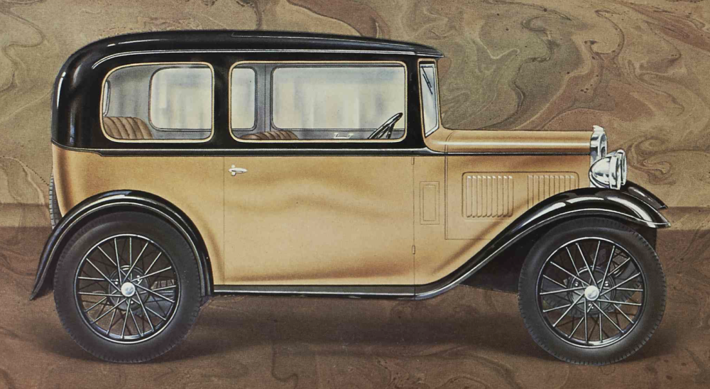

Frank, as a general guide I would suggest that RNs retained the body-colour on the bonnet with just the waist moulding in black, whilst RPs continued the black across the whole top of the bonnet, although the 1934 sales brochure might suggest otherwise:
.jpg   1934 RP sales brochure.JPG (Size: 137.24 KB / Downloads: 575)

All Austin de-luxe models from 20hp to 7hp followed the same rules in 1933.
De-luxe paintwork was available as "Black top" in which case the lower part of the body, the bonnet top and the window reveals were  painted in a contrasting colour.
The only time a black bonnet top was used was with an all black de-luxe.
from p16 of the June 1933 catalogue.

Always treat brochure illustrations with caution! Note the RP illustration used in both 1933 and 1934 catalogues show a body-colour border round the windows - this was a feature of some RLs and RMs which the Publicity Department obviously thought would enhance the illustrations in later catalogues, but I have never seen an original RN or RP with such a colour scheme - but I have certainly seen original RPs with black bonnet tops over coloured lower bodywork.
