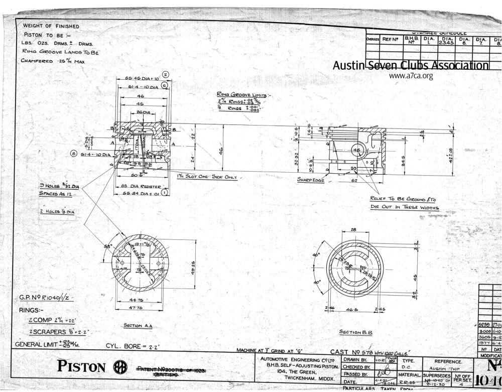

BHB were at least around until 1956, their piston drawings are available from the archive, some show 'without' oil holes and this one shows 'with'. I'd venture that as long as a bit of metal is left to support the gudgeon pin drilling two wee holes is unlikely* (*all the usual caveats apply!) to cause you a problem. On the other hand it would appear they made plenty of pistons without them.

Chris - thank you too for once again coming to my assistance.  I never realised quite how many features had to be machined and measured on a piston.  Interesting too that the what looks like a pre-war drawing uses a mix of metric and imperial units, clearly noting a 2.2" cylinder bore but showing piston dimensions in mm, apart from the gudgeon pin lubrication holes that are 1/8" dia!  I haven't actually compared the drawing with one of my pistons but, at first sight, they match.  I shall now mull over whether or not to drill the additional holes.

Whoever scanned the drawing cut the change history off, but as far as I can tell the holes were added in an update around 1935, suggesting that they were deemed an improvement. I would only worry about adding them if the boss looks insubstantial. Seven Workshop pistons have holes here and are completely dependable.

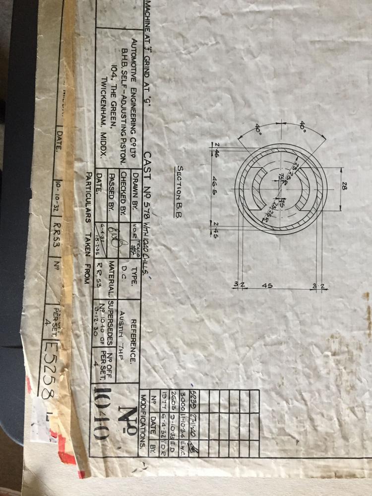

As it happens, I am taking the opportunity of being confined to barracks to sort out all the engineering drawings and digital images. I am hopeful that a completely new resource of all we have will appear on the Archive web site in the next couple of weeks. This will include some important historic drawings that have not been published before.
Fortunately, the piston diagrams are some of the drawings I have at home at the moment, so have been able to take a close up of the missing information. The existing images will form the basis of the new resource, but will be re-digitised as time and resources permit, to replace the versions made some time ago with higher quality ones.. My apologies for the rather 'jaunty angle'..
Hope that all helps..
RE: Gudgeon Pin Lubrication - John3528 - 22-04-2020
My thanks to Chris and the Archivist for their researches.  There's something rather special about being able to look back at working drawings from almost 90 years ago!
