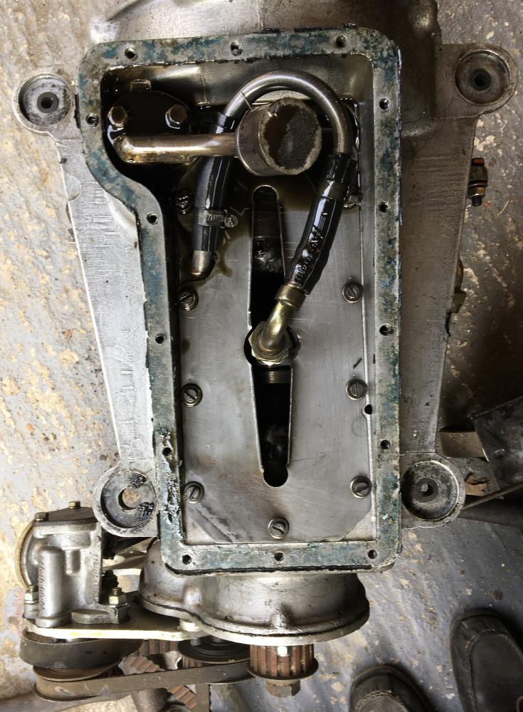

RE: 3 Bearing Engine - Stuart Giles - 21-10-2019
(21-10-2019, 11:40 AM)Chris KC Wrote: new A7 3-bearing cranks are available in Australia.
That looks like a Reliant SV crank and rods in there right now. Wasn't easy to find the parts for this conversion 30+ years ago when I last worked on one. We also found out the hard way that huge oil pressure is necessary to get the bottom end to live on a blown motor where the oil is feeding all the bigends via the centre main.

RE: 3 Bearing Engine - Henry Harris - 21-10-2019
It is indeed Reliant crankshaft and rods.
