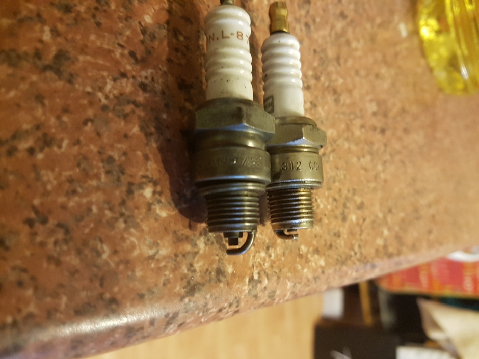

RE: Ruby mk2 spark plugs ? - Hedd_Jones - 23-09-2019
like this?. The one with the protrusion is a L87Y. Ive never tried it as I only have 1.
[Image: 008_1815.jpg]
RE: Ruby mk2 spark plugs ? - David Stepney - 23-09-2019
If memory serves me aright, the 'Y' suffix on Champion plugs denoted an extended nose. The idea was that the plug tip would extend into the hottest part of the flame and be less likely to foul.
