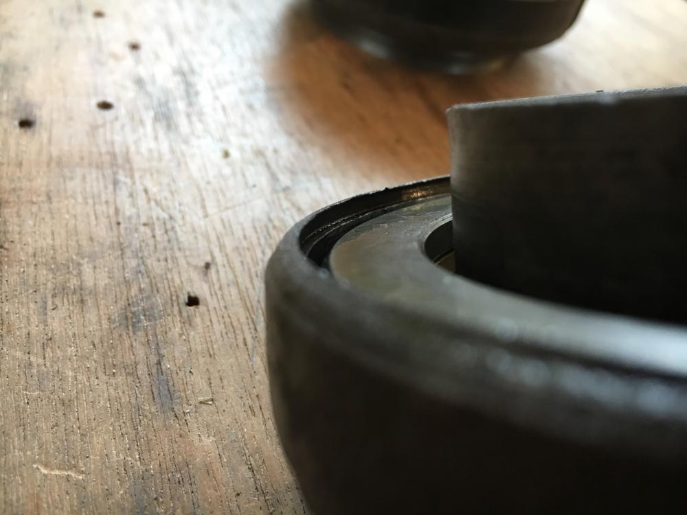

RE: 3 speed thrust bearing - Mark Atkinson - 30-08-2019
Thank you Ian and Tony,
This certainly was not easy to disassemble, the lip holding in the dust cover is a stout one. It looks to have never been taken apart before.
As you will see in the attached pictures, the old cover distorted considerably before it came out, the force of the press breaking the old bearing. the retaining lip partially distorted in a couple of places, but, it was mostly the dust cover that bent.
I assumed that the new bearing would come with a pre fit dust cover that would be dished, so that it would 'press' into the lip under pressure, but I can see no way of doing so with the flat one.
As you will see in the picture, I put a lever under the retaining lip in the housing and managed to put a small bulge into it, it took considerable hand force to make this little nick! Have I found a new variation in Austins thrust bearings?
Thank you Ian and Ruairidh,
I have a new bearing and cover from the Austin Seven Workshop, my problem is that the old one was very difficult to remove because of the substantial dust cover retaining lip, which resulted in the distortion seen in my pictures.
The new dust cover has a diameter which is 2mm larger than the diameter of opening in the housing.
I had a phone chat with Tony B after his post and decided to roll back the lip, which took quite a bit of time and force, following which I managed to spring the new cover into place in the housing. I then dressed the lip back down to retain the dust cover.
I think I have just been unlucky that my housing had to much material when Austin made it in 1925.
