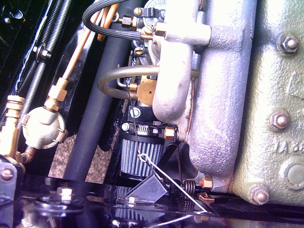

RE: Fuel Additives - Dave Mann - 25-07-2019
    Does your car have the plate from the body side under the exhaust as shown in the photo. One of our RNs had this plate and suffered from the fuel boiling in the float chamber,  the other one didn't have the plate and didn't have a problem so the plate was removed.

To Dave Mann, I don't have the flitch plates installed (Plates below the exhaust pipe),  also note that your RN has the expansion loop in the vertical plane.
