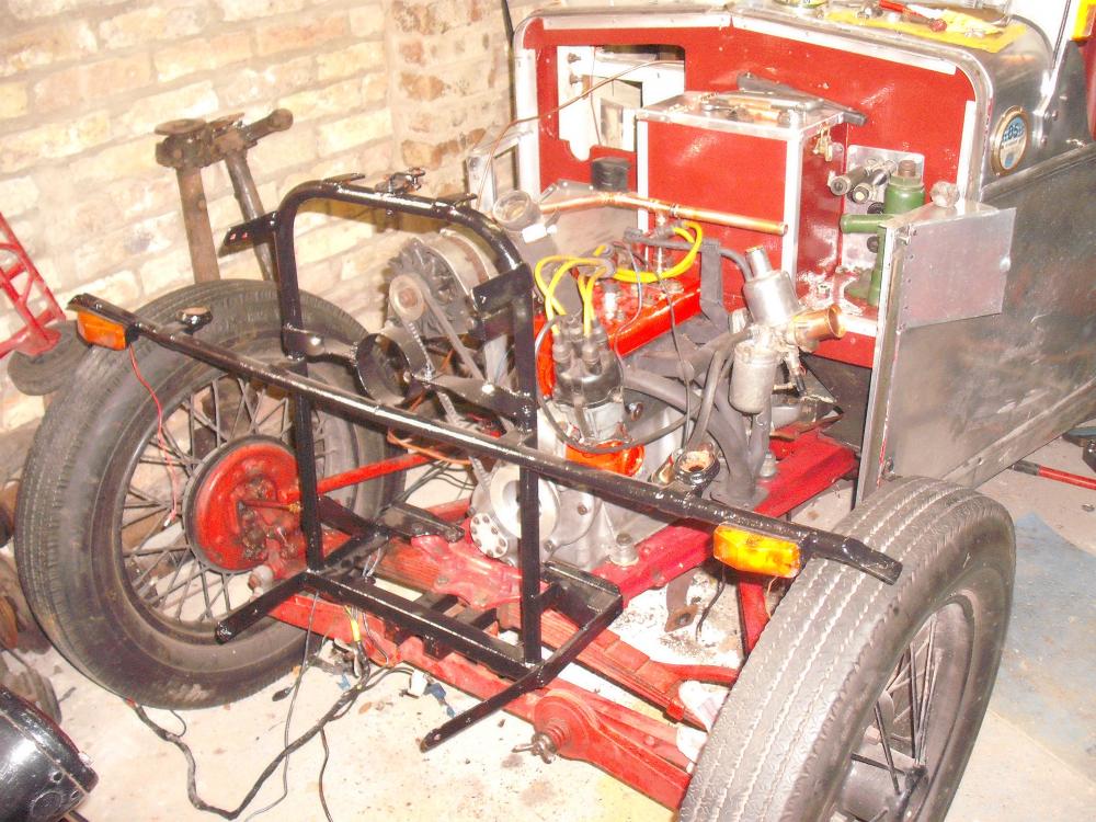

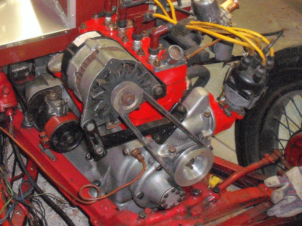

Depends what you are using the conversion for. If its a special This is the conversion I made in the 80's using a mini alternator. I had a friend who turned a v belt pulley for the camshaft in Ali and a steel shaft to use the original dynamo end plates without the commutator. Then turned the fan casting through 180 degrees. It was a broken one so I could file the remains of the fan hole off. The bracket for the alternator is bolted to the fan casting. It has worked without problems ever since. The mini alternator dose not need a cut out as its built in. I have converted my big 7 in the same way the cut out is now only used as a junction box. Now I can blind Range rovers back!!
Photos
Photos
    Photos
        Photos
Sorry finger trouble
        Sorry I am trying to post a photo but they seem to be too large to be accepted. Will try another
    Better photo

RE: 12 Volt Conversion - Howard Wright - 28-05-2019
Hi
On my special (up for sale at Brightwells Leominster on the 10th July) I used the existing fan pulley and a ribbed belt to drive a Kubota mini alternator mounted on top of the dynamo housing.
the only fabrication needed was brackets for the alternator!
