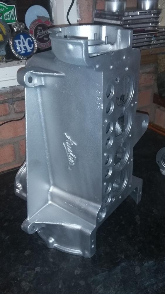

RE: Stripping paint off Aluminum parts - Chris Garner - 12-02-2019
Aqua-blasting. A crankcase I had done recently.

RE: Stripping paint off Aluminum parts - Chris KC - 12-02-2019
(12-02-2019, 12:30 PM)Chris Garner Wrote: Aqua-blasting. A crankcase I had done recently.
Gosh Chris that's clean - but how do you eat your dinner off it exactly?
With a knife and fork, Chris!
