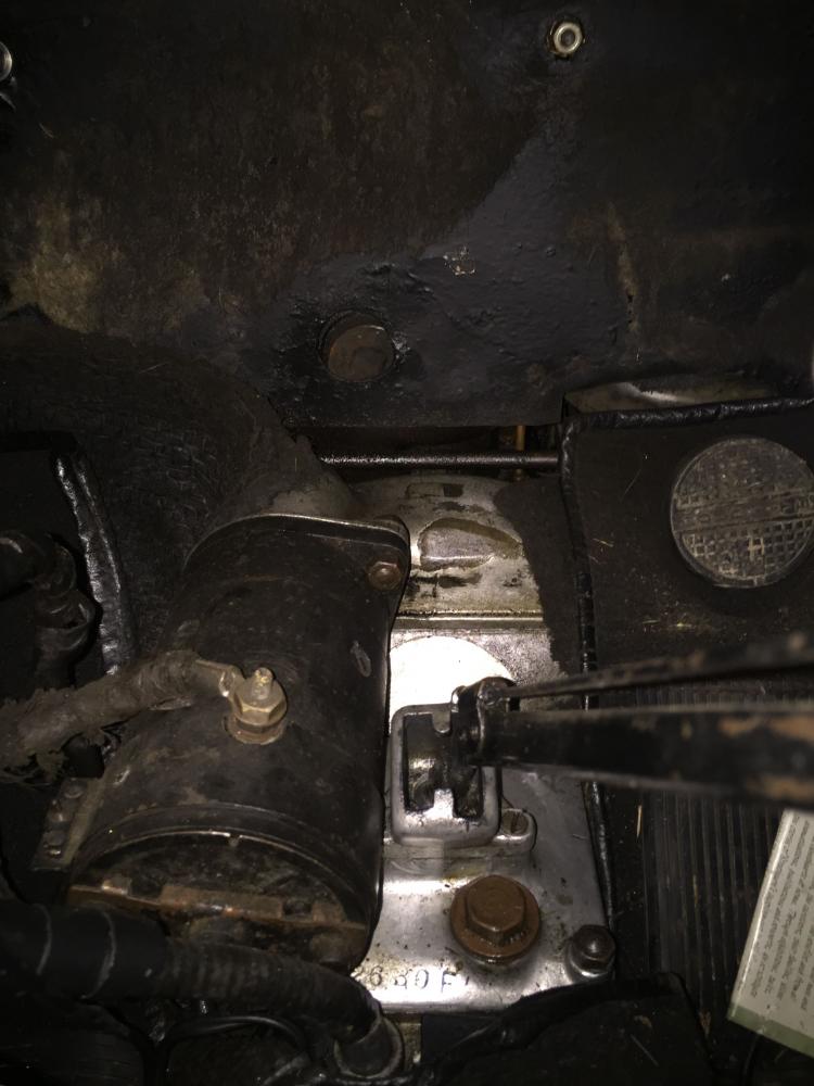

RE: Bacon slicer starter and floor mounted switch. - Ruairidh Dunford - 29-10-2018
(28-10-2018, 12:26 PM)Robert Leigh Wrote: The later starter will not fit a gate change gearbox.
Hi Robert,
My own Chummy has had exactly this set up for a number of years.
R
