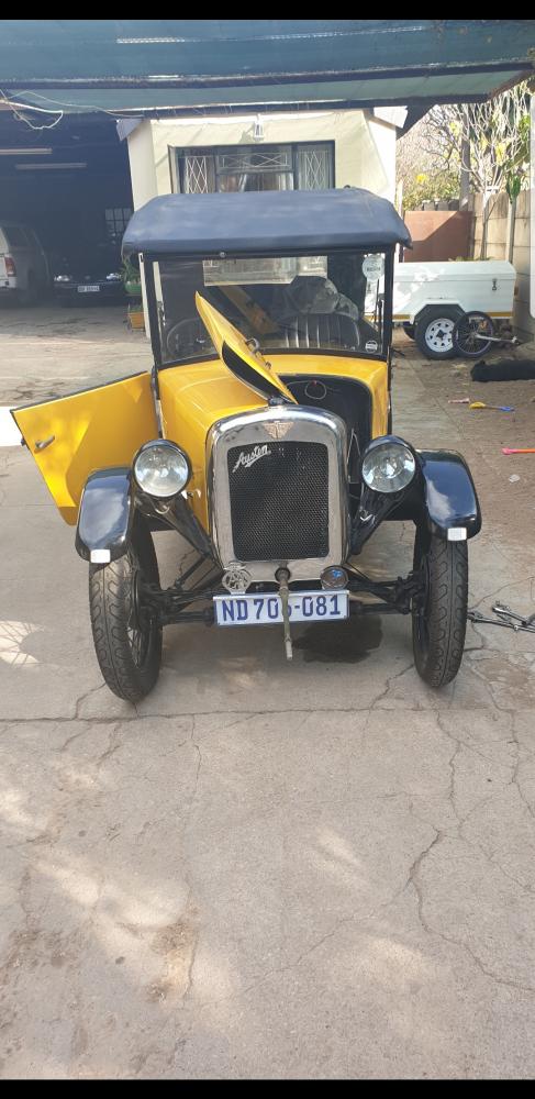

Good day. I'm from South Africa and recently bought a Chummy. Can someone please assist in confirming the year, and maybe reasons for learning purposes?
RE: Chummy 1928 or 1929? - squeak - 15-09-2018
I'm going to stick my neck out and say 29, it has the taller radiator, the larger headlights, one piece windscreen  although in the colonies we had one piece earlier. It probably has coil ignition and glove boxes each side of  the dash panel as well. cheers  Russell

The car is undoubtedly a 1929 model, but it could date from late 1928. The taller plated radiator was introduced in August 1928, followed by coil ignition in September, whilst the early-style wings as seen on your car were replaced by a heavier style in September 1929.

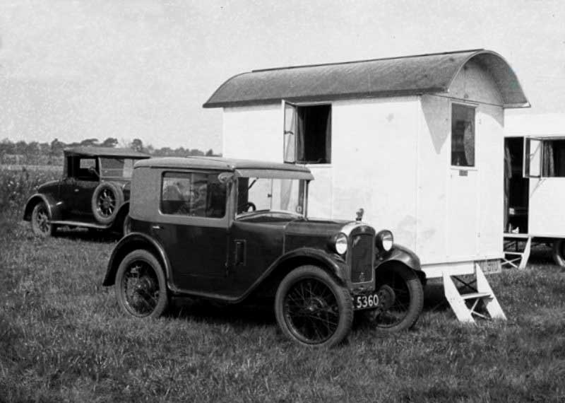

[Image: 158_20_02_18_2_52_25.jpeg]
This shows the style introduced in September 1929; a very similar style but with a raised rib round the edge of the wing came in January 1930. Note the larger valence by the headlamp at the front, and the longer rear wings,
