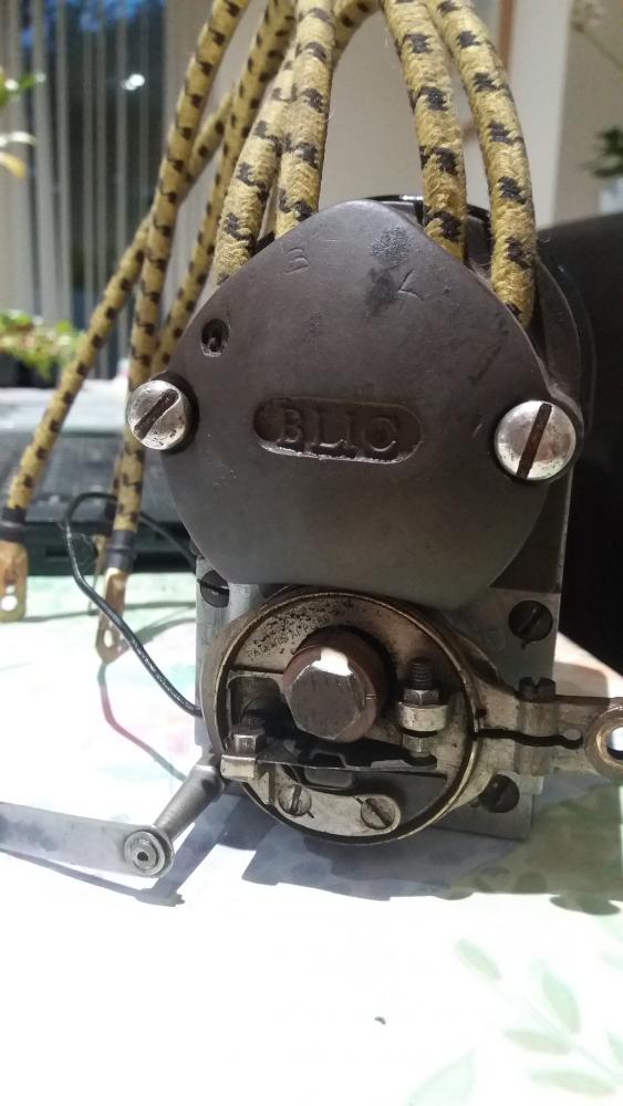

I am faced with a slightly odd problem that I hope someone can help me with. I sent a completely 'dead' Blic Magneto to be rebuilt. On the casing, it has an arrow engraved on it indicating a clockwise drive. However, when it was rebuilt, I was told that it was orientated to an anti-clockwise drive ! In that direction of rotation, it has a brilliant spark. I wondered if anyone knew if there was a way to alter its internal configuration to suit clockwise rotation (? a different cam) or some clever gearbox device that I could fit externally to reverse the direction of its drive?

Thanks for your usual quick replies. I thought that the direction of rotation would not matter too much but I've just taken the one off the Chummy it was destined for and the direction of the Rotor Arm is the same but it 'sparks' quite well if the Mag. drive is rotated clockwise but not at all if spun in the opposite direction. opposite to the one that's just been rebuilt. Points to some sort of internal shenanigans that's beyond me! The chap who rebuilt is very experienced and seems to think it is the cam that's at fault but I'm not sure why. By re-timing, Stuart and Stev, do you mean taking the main gear off and altering its position to smaller one ? I would've thought that no matter what its position, it should spark in a clockwise direction.

The spark is generated when the poles just separate and the points open at the same time. The exact timing is a little more complicated than this but that is why rotating in the other direction does not work.
This can be re-timed by re-positioning the cam with the rotor and rotor arm in the correct positions.
However, the points are only supposed to run in one direction. In the correct direction the points will effectively open themselves whereas in the wrong direction they will try to dig into the cam and result in excessive wear. The points housing has to be of the correct rotation.
Some magnetos with an extended pole (for better spark in advanced and retarded position) cannot be reversed.

Thanks, Adrian I've looked at the points of both magnetos and the two sets look quite different and like you say this is probably because they are orientated to a different rotating direction. If I find another Blic, if I change this bit over and re-time (?how!) then I might get closer to a solution. I'll have a rummage about.

The relation between the large and small gear wheels only controls the position of the rotor arm when the mag fires, important but not the same as the mag internal timing. There are many articles on the web regarding internal timing.
Some mags use a keyway to fix the internal timing.
