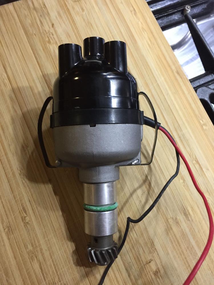

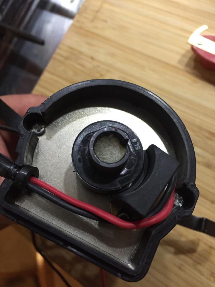

I just spoke with JonE and he is keen to see what is inside the units, I will post a couple of pictures later on for him and others of you who are curious.
RE: electronic distributors - any further feedback? - Ruairidh Dunford - 29-08-2017
Here they are...

RE: electronic distributors - any further feedback? - JonE - 01-09-2017
ooh... mine's got an oiler port!
90 degree alloy tube with a rubber cap.
Is that a new update? I can't quite see from your pics, R.
RE: electronic distributors - any further feedback? - Ruairidh Dunford - 01-09-2017
Yes - the newer ones come with these - just a press fit though.
