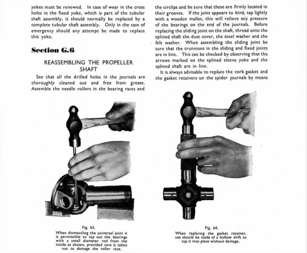

RE: U joint woes - Jeff Taylor - 04-07-2018
Hi Erich,
Instructions for fitting new Hardy Spicer U/J's on a mid to late 1930's Morris 8 prop shaft :-
Jeff
RE: U joint woes - Erich - 04-07-2018
Thank you Jeff. This is very helpful. I've order the bits and will be changing out soon.
Erich in Seattle
