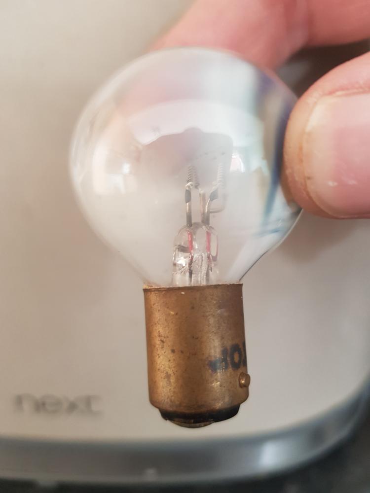

        [attachment=2646]
Thank you in advance for anyone that might be able to help me.
I have a 1931 RN Saloon 6v twin filament headlights, (the bulbs that you have to focus by sliding in and out to get a decent beam pattern).
The bulbs are 30w-30w or 35w-35w would do, bottom cap is approx 1.5cm across, 2cm from terminals to glass bulb and pins symmetrical.
Can anybody tell me where I can buy two of these by post?  I think the seven workshop list the correct type beside the other pre focus type.  See photos attached, the bulb I fitted today was the last of my spare ones about 40 yr old and had the number A235 on the cardboard box but can not get any result for this online.

Try JB Vintage Spares. Is that your bulb first on this page?
http://www.jbvintagespares.co.uk/shop/4561158207/6-volt-Light-bulbs

I am interested in the type of headlamps fitted to your RN. Currently I am preparing a series of articles on A7 lighting and I have found that the early RN's had Lucas R47's fitted with 'Lucas Graves' double filament dipping headlamp bulbs later being changes to the Lucas type 35/32 still fitted with the 'Lucas-Graves' bulbs and both with 'reeded' glasses.
These bulbs are still available but are more usually known as 'Bosch' bulbs. They have a larger diameter metal body and small and larger rectangular lugs (unlike the round pins normally fitted to bulbs), the purpose of these lugs is to ensure that the bulbs are inserted the correct way up to give the dip/main orientation.
The bulbs that have been identified as available would fit the 'scuttle' lamps (raised in an earlier posting) although there is no facility for focussing them.

Keeping it in the Seven family, they are available from our cherished suppliers.
David (A7 Components) has 24/24W BG923 HERE, or Seven Workshop have 35/35W HERE
