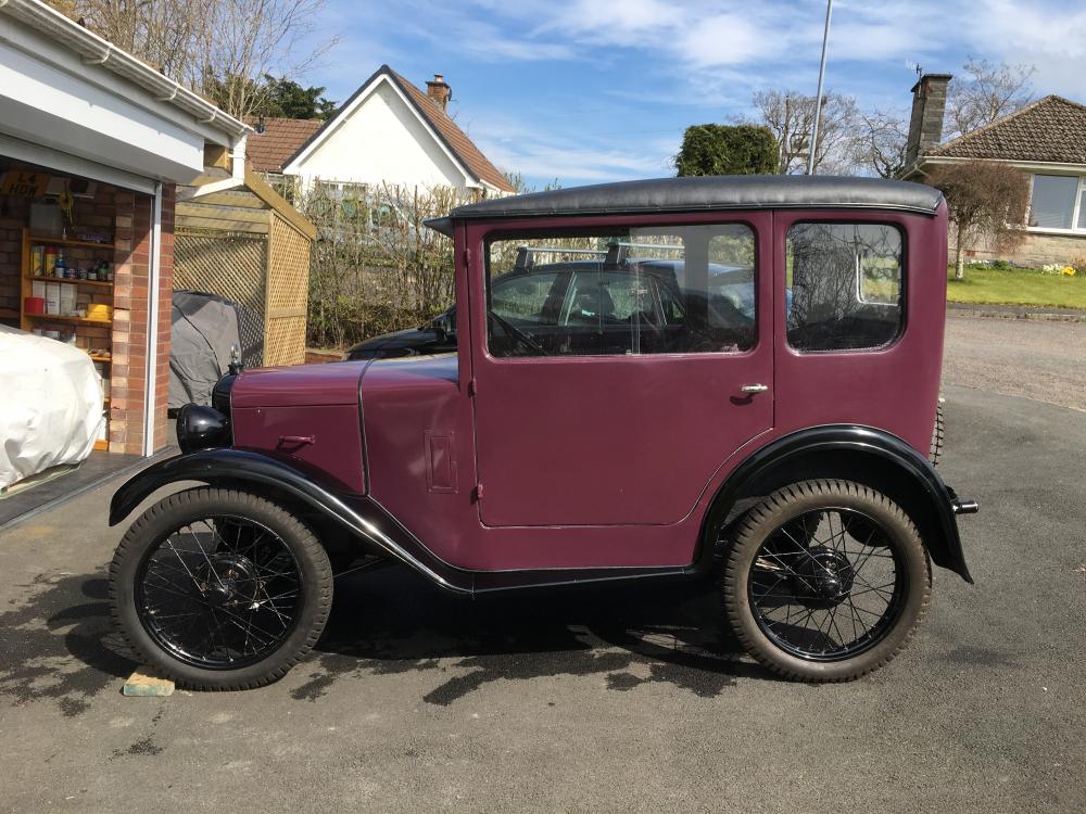

Might seem a bit tame but I've been doing some shake down trials in the RK after finishing the back axle (the final?  no next to final?  well its nearly finished!)
So a quick trip down to get the paper.
PS End result is a strip down of the torque tube bracket (It sounded like a teenager was using a full drum kit under the car)
RE: What have you done today with your Austin Seven - Greig Smith - 24-04-2019
That's a very pretty little RK Howard, please do post some more pictures

RE: What have you done today with your Austin Seven - Howard Wright - 24-04-2019
        Hi Greig
Thanks for the kind words.
Doesn't take much to make me show off!
