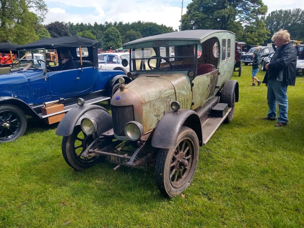

I did nothing to my seven today, but enjoyed a day at Tractorfest at Newby Hall. Here is my 1955 Austin parked next to one of only two (I think) sevens there today.
Interesting for me today was this 1926 Bullnose Morris van. In 1926 my dad became a delivery driver in a Bullnose Morris van, but this is the first time I've come across one.
RE: What have you done today with your Austin Seven - Ruairidh Dunford - 08-06-2024
That van is superb!
RE: What have you done today with your Austin Seven - andrew34ruby - 08-06-2024
(08-06-2024, 07:04 PM)Ruairidh Dunford Wrote: That van is superb!
Apparently Morris never made a van, but this van back end and roof was supplied off the shelf by a coach builders and it was very easily removable.
RE: What have you done today with your Austin Seven - Peter Naulls - 08-06-2024
I wonder if the coachbuilder was Thomas Startin? the details are very reminiscent of a Chummy van.
RE: What have you done today with your Austin Seven - andrew34ruby - 09-06-2024
Only one seven at today's car show at Harewood, and many of us have seen it before. Interestingly there was another seven owner who has recently bought the Rolls Royce. A bit of a contrast from a seven.

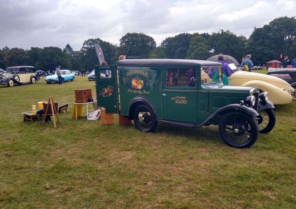

In my driveway, today... similarities with the Morris are stark.

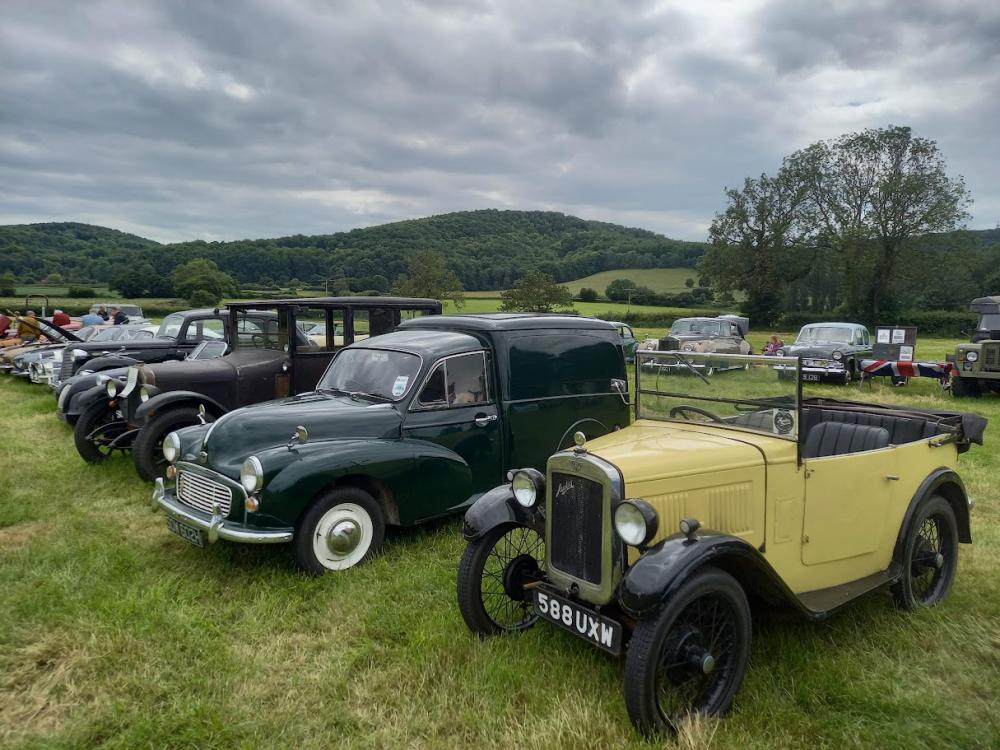

I’m a driver……but often some distance to ‘shows’.  Not sure if Club Rallies count as shows but we had a 160 mile round trip to Bryngarw for the South Wales A7 rally.  Not the furthest traveled by any means with Phill Snell travelling 180 miles each way from Axminster in Devon (photo of his amazing Ruby may appear in the 2024D Grey Mag)!
Always a super event…..didn’t have time to count the cars but more than thirty, surely.  Youngest exhibitor, just two years old (again photo in the 2024D Grey Mag [2024C is at the printers]).
Just one photo….what a lovely view to wake up to from the tent door…..those cars whose owners had survived the previous night’s bbq  Big Grin.
