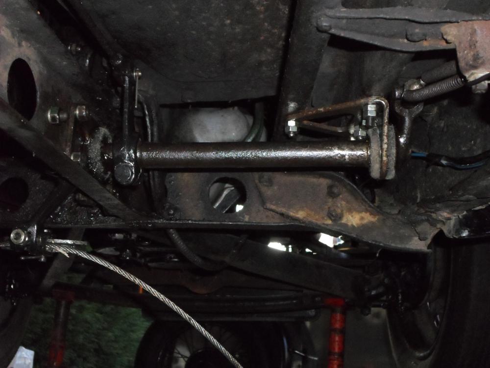

Don't know if the attachments will be there but I have sent 2 photos of the brake cross shaft where it meets the front cable. I have full Girling brakes on both my Big 7 and Ruby special I recently bought a new yoke etc illustrated with the spare cross shaft (Ruby). My Query is when did the threaded screw in pin come into use. Was it only on the full Girling cars as it is on both of my cars and this spare shaft. None of them are threaded for the yoke to be screwed through. This makes it easier to set the tension on the front cable. As you push the threaded part of the yoke through the pin tighten it with the nut and lock it with a lock nut. Any thoughts

RE: Just how good should the brakes on my Ruby be? - Ian Williams - 25-04-2019
Only one picture is there Peter, you are showing the threaded pin at the brake rod end of a full grilling cross shaft and reproduction pin and yoke that is fitted to the drop arm at the opposite end of your shaft. On grilling cars the brake rod pin is threaded on one end but has a plain bore clearly shown in your picture the drop arm end the pin is plain with a threaded bore as per your reproduction also pictured. I am unclear what you are asking unless you are confusing the two?
RE: Just how good should the brakes on my Ruby be? - Peter Sweeney - 25-04-2019
You are right I have confused myself with the spare on the bench. This is the one fitted on the Big 7
As you can see the screwed pin is on the right  Confused my self
