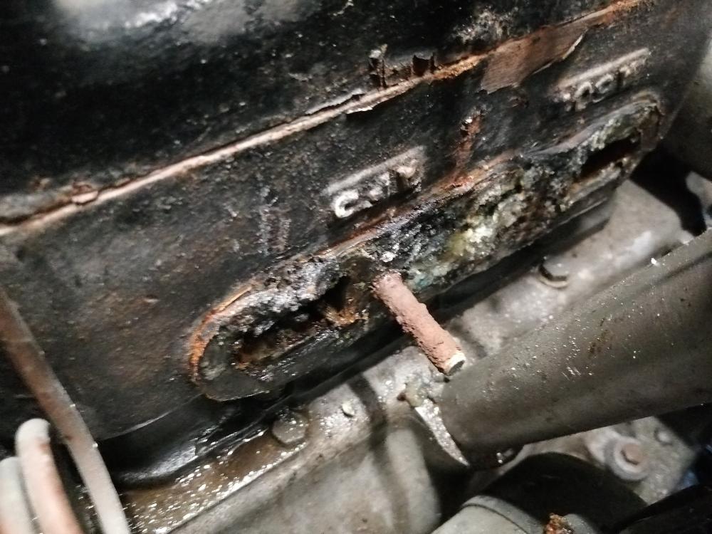

Yesterday I removed the side water manifold due to a leak on a car that iam currently recommissioning following it being laid up for around 9 year.
Does anyone have a suggestion for a good flush that will break this down?

In the past I have had a puggle around with a coat hanger, flush everything through with a pressure washer, filled the system up with water and Fernox, run around for a week and flushed everything out again and what came out was astonishing!
I’m not sure how nasty Fernox is, but it worked well and didn’t appear to cause any damage.

I found a similar build up in the engine I took out of the box, an engine father had apart about 7 or 8 years ago. The rear part of that was blocked.
Father had been using neat water latterly as oil was getting into the water. I changed head and fixed that and used glycol.
The build up had a blue tinge like yours, so its antifreeze based. I soon found a void behind it when poking about. So it was local to the ali (which was actually perforated in spots after a clean - despite not leaking in service)
Probably explained why the swine ran warm.
Is it from mixing antifreeze manufacturers products? or is it a reaction with the ali?
