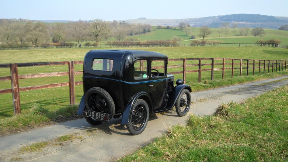

I needed some shopping from Thirsk so I took the RL saloon.   It went much better than when I had it out two weeks ago, probably because it was a much warmer day. I couldn't resist using a lovely white road just outside the village where I live.
RE: What have you done today with your Austin Seven - Hedd_Jones - 22-03-2022
Malcolm, very nice. When I restored by RL I wanted to paint it black. I had red wheels in stock. I wanted black over black, red wheels and trim. I was persuaded out of it, and went for a dove grey body. No regrets. But your car looks stunning.
