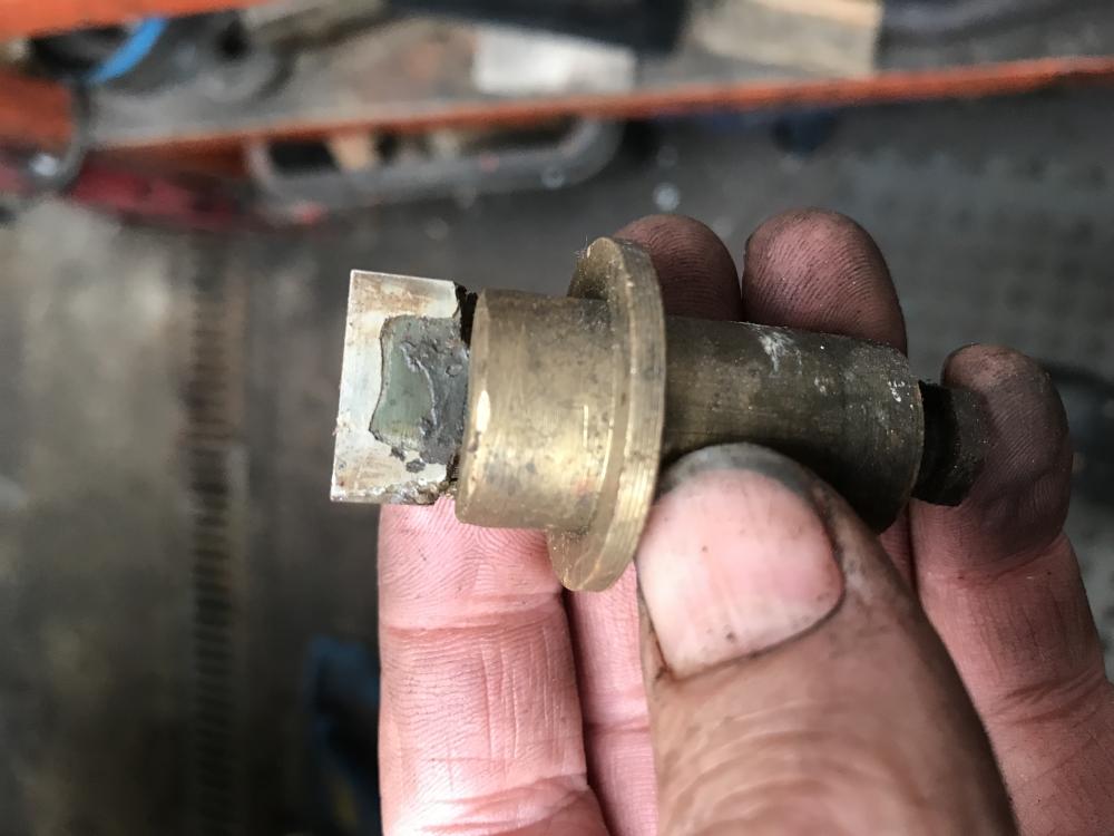

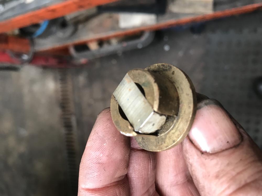

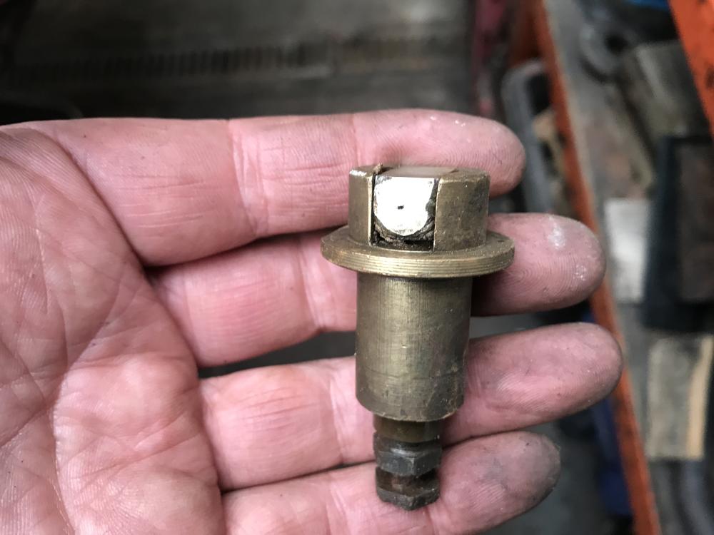

RE: Modified Cam Followers - Ruairidh Dunford - 06-09-2024
RE: Modified Cam Followers - Nick Lettington - 07-09-2024
Was that from an engine you are stripping for refurbishment Ruairidh or something in your rogues gallery?
RE: Modified Cam Followers - Ruairidh Dunford - 07-09-2024
I recalled someone asking about them, perhaps it was you?
They were in a box of spares - would you like them?
It was me who asked if anyone had ever tried it. Interesing that Chapman's design made them concave. I would like them Ruairidh, like those cast wheels,  but I'm trying to quit the habit.
They will be sent south next week…
