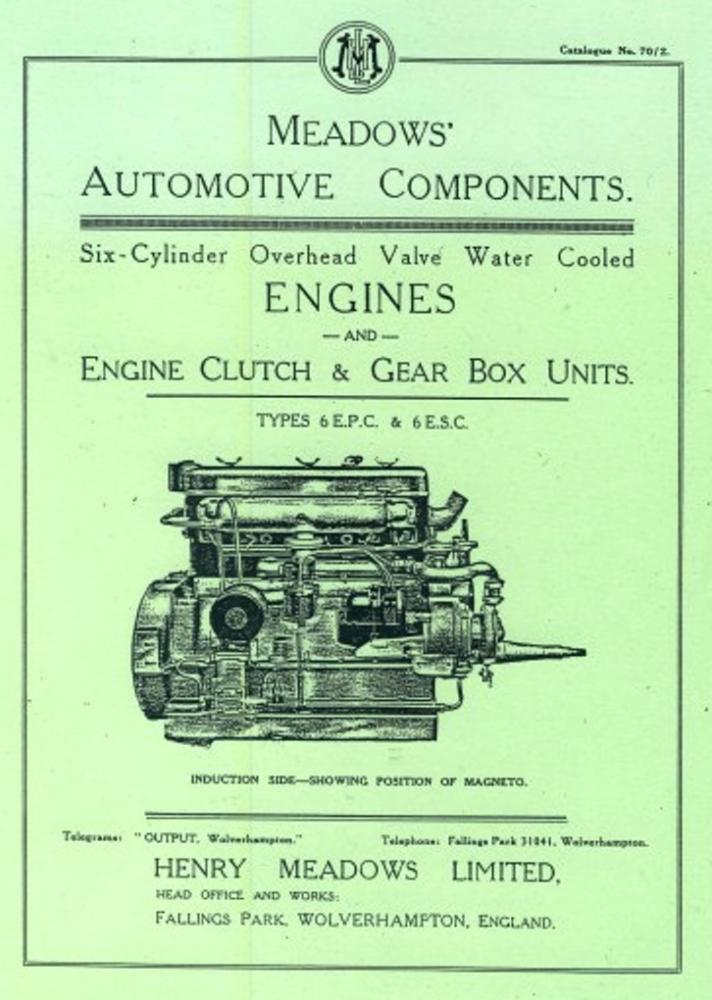

References to speedboat carbs got me thinking about carbs on Meadows engines. In car use almost always SUs, but I cannot recall whether or not the Meadows in double diagonal speed and RAF boats had SUs or another make. There used to be a couple of such  on Loch Lomond and the Scottish Maritime Museum certainly had at least one ex-boat Meadows in the stores, maybe one of our distinguished Scottish members might investigate. There are certainly none on the Mon & Brec, otherwise I'd go out into the rain and peer into the engine bay.

Many years ago I bought a brand new Meadows 4EC marine engine, which was fitted with an upraft Solex carb; this illustration is of a mid-1930s 6-cylinder Meadows marine engine, and it looks like that also has an updraft Solex:
