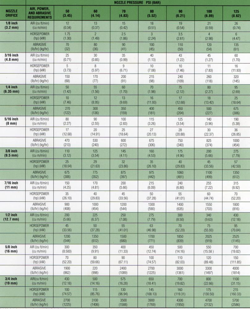

One thing to take into account with Abrasive blasting more so with using suction is wear in the nozzles,
Going from 2mm to 3mm will double the volume at 90 PSI from approx. 8 CFM to 16 CFM,
This is why very important to renew nozzles regularly as you will soon exceed the capacity of the compressor.
going for a bigger size nozzle does not work it will only slow the velocity of the abrasive medium being used and will not be as Effective.
To put this in perspective When I was running a 200CFM compressor the max nozzle was 8mm at 90 PSI

I have been to the workshop and the ceramic nozzle is lableld 6mm but measures to 6.5mm so not too worn but perhaps too big for my 3hp compressor with its 150 L tank.
Running with the 2 compressors in tandem they should have a combined 6hp and 250 L tank capacity. I suspect the 6.5mm nozzle will still be too large for high velocity garnet flow.
The web site suggested does have an interesting table of pressure, HP, and nozzle size.  I will experiment and report back, probably in a week due to workload . Thanks for your input,  Russell
RE: Home garage compressor. - Colin Reed - 08-04-2019
Hi Russell,
This Chart will make it easy to figure out what is required
Just a couple of things for best results
                        PSI needs to be between 90 and 100
                        Also allow 30% more capacity than the nozzle requires to allow for wear
Colin
