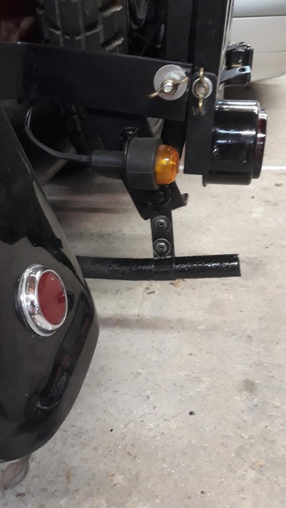

RE: What have you done today with your Austin Seven - Reckless Rat - 09-07-2020
I have done a similar type of exhaust mod on my RP but without the butchery. I am fortunate in that the car is fitted with an after-market rear luggage rack and the bracketing provides for an easy solution to rear tailpipe mounting. The last bracket on the system is at the rear end of the chassis extension, and it doesn't fit very well which means that the "up, over, down and out" part and the tailpipe are unsupported. This little mod stops it from flapping about and banging on the underside of the fuel tank:
