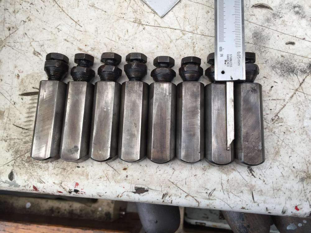

Race engine cam followers asymmetric inlets 1.6" radius exhausts, shortened (nut taper removed) high tensile locknuts reground tappet screws. Allways check the thread depth of the follower to make sure there is enough metal to grind off.       Terry.

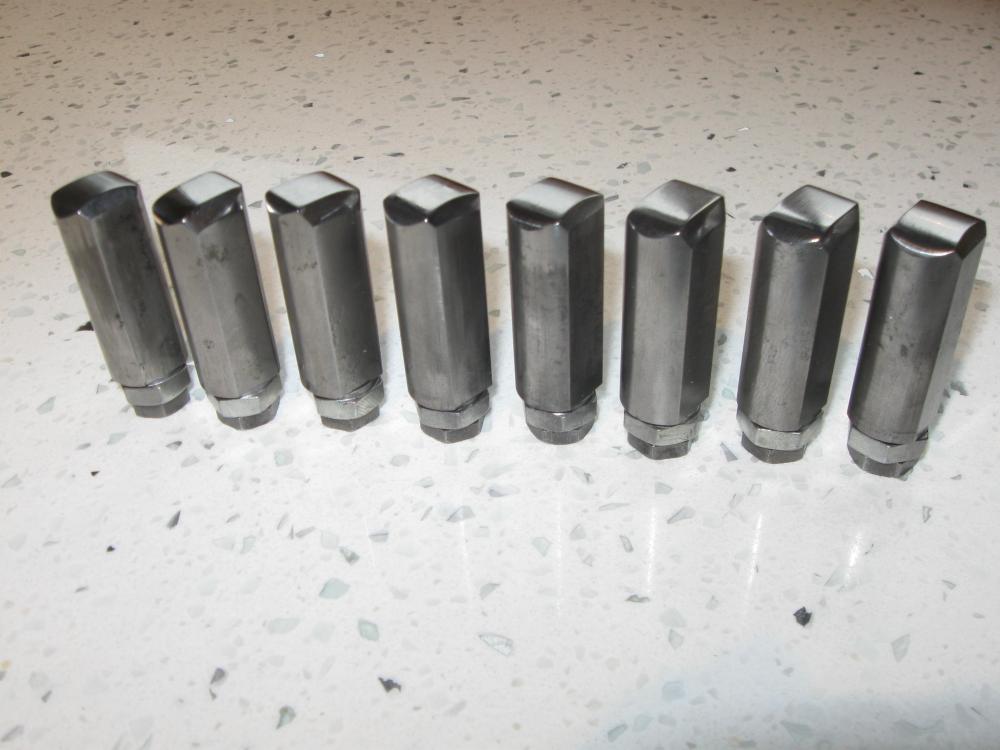

(21-08-2024, 05:22 PM)Nick Lettington Wrote: I have often wondered if, using the brass cam follower guides from a very early block,  it might be possible to manufacture and fit some fiendishly clever cam followers like those a certain Mr Chapman made for the Ford 1172.
There's probably a good reason why no-one has.

Does anyone have a view on which cam timing would be best suited for a sports road engine with 3/4" radius cam followers or flat cam followers? And how does a standard cam work with these 2 follower types?

For a road engine there isn’t a lot wrong with a standard cam and 3/4 radius tappets. People used to retard the cam slightly by using a stepped woodruff key but really there are easier ways of getting a bit more out of your engine.

I won class 1b in the vscc 4 years out of 6 and came 3rd the other two using a standard cam and 3/4” rad followers on a 11/8” SU on a ruby inlet.
