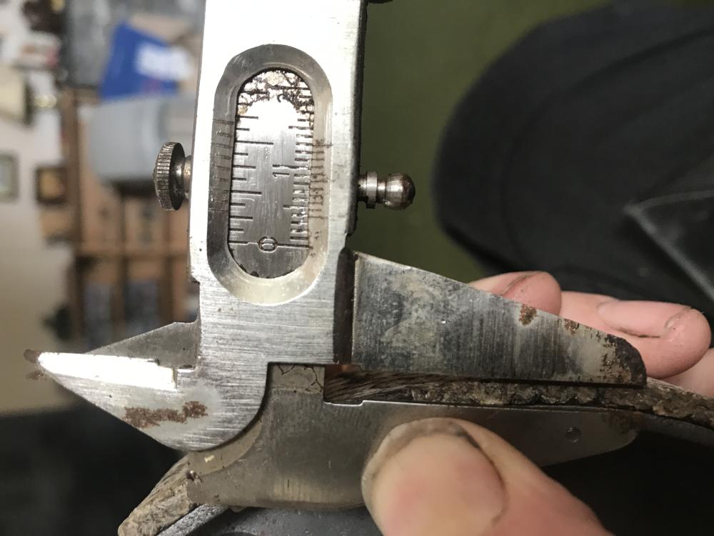

please post photos of your front brake set up which shows clearly the position of your levers at rest, with drums fitted.
Please also post a photo showing the thickness of your new brake linings, use a set of digital callipers, if you have some to hand.

Hi Ruairidh, the linings are approximately 4.2 - 4.4 mm thick. Including the shoe they are approximately 7.0 mm thick.

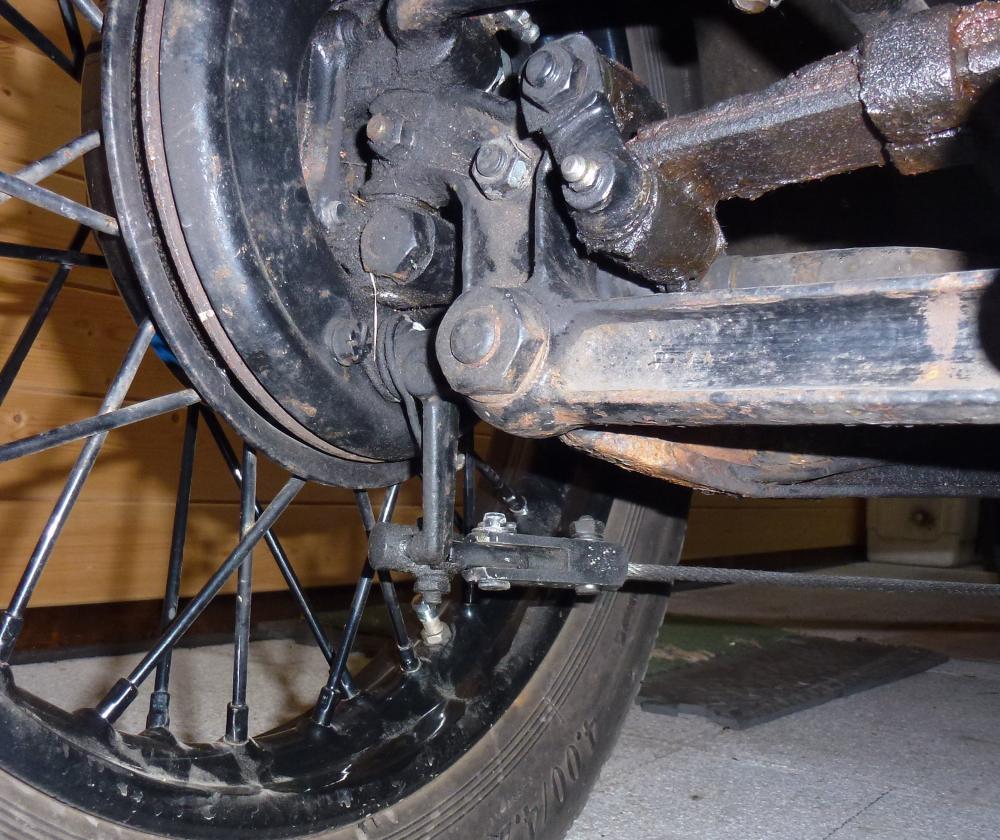

The photo below is of my own setup, the levers are from Seven Workshop but I cannot remember the source of the cams. The handbrake is on (which fully applies the rear brakes and lightly applies the front brakes) but the travel from off to on is pretty small.  As you can see, the lever sits more or less vertically and the cotter nut is to the rear.

You have the cotters correctly orientated for a Girling system and although the levers are forward and down, the ends are sitting up higher than I would expect.
This is one of my own cars, with handbrake fully applied (note, I prefer to set up the system up so that front brakes are fully on with the rear just starting to come on).
I have measured several NOS linings that I have here and they all measure exactly 4mm.
The lack of top adjustment on your car can only really be attributed to the linings being too thick, even with new I can normally still get a couple of clicks using second hand drums.
