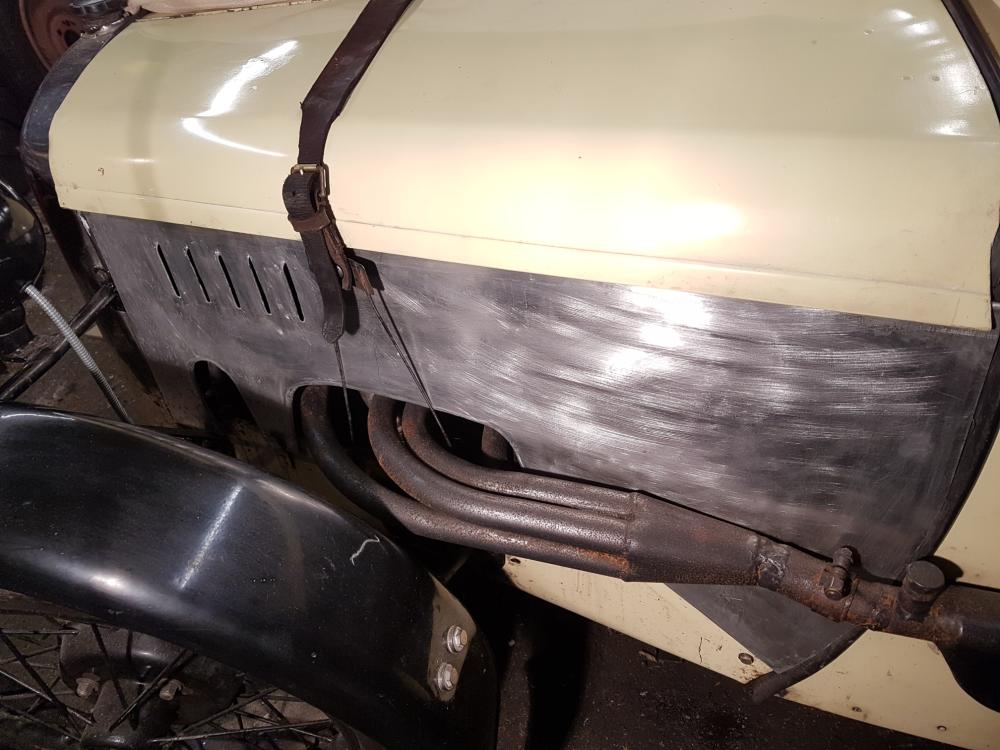

I took inspiration from your work Ian and Mark Atkinson's Slippery Anne progress and made a panel and the louvre press I needed from some MDF, a bit of ash and a Dremel. I wouldn't want to use that approach in a production environment but I'm a bloke in a shed, doing it for fun.

RE: A question for you body builders - goodwoodweirdo - 14-11-2022
Rather than mdf buy yourself a few cheap polyethylene food chopping boards they'll last longer, same amount of effort to shape as mdf ....
just nip into the kitchen, sure the wife wouldn't notice her chopping board gone Big Grin Big Grin Big Grin
Very nice louvre's btw.....

Excellent Charles! I am pleased to see I inspired someone, your home machining work has a similar effect on me.
