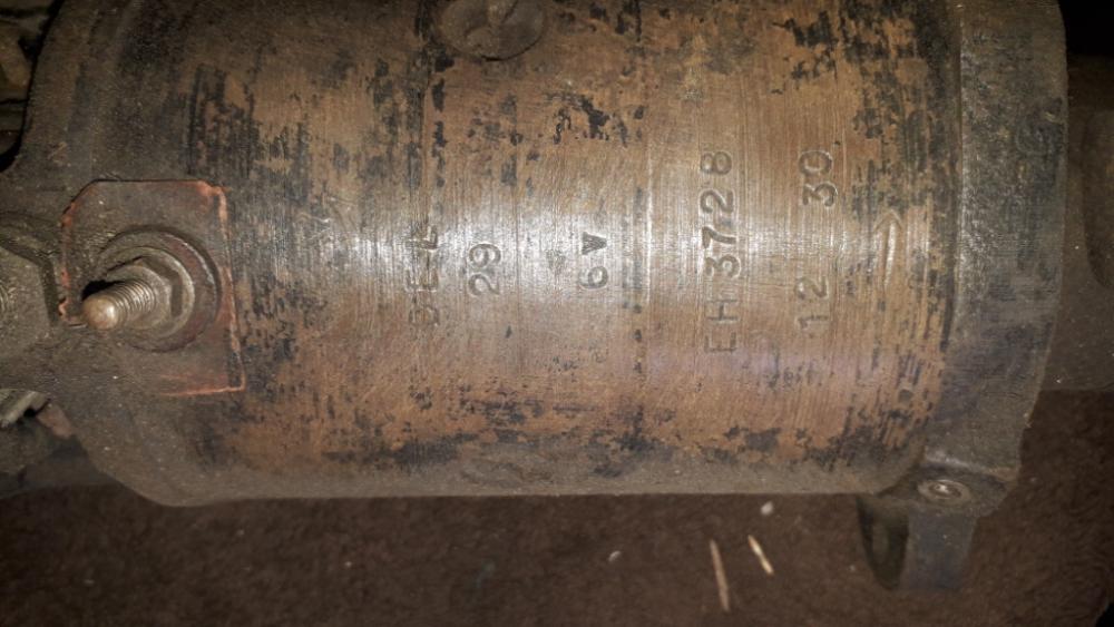

RE: Dynamo identification - Steve Jones - 04-07-2022
As said previously, the only way you're going to identify your dynamo properly is to remove the paint adjacent to the connector post. Here's one I've just done that to and you can see the various markings. The DEL dynamo can have either a steel or aluminium end plate, earlier, aluminium, later steel. In the case of this one, steel.

RE: Dynamo identification - JonE - 05-07-2022
I'm presuming Steve's pic is dated Dec '30 from the stamp - see what yours says, k82, in the same location, from Parazine's date range above...
RE: Dynamo identification - Parazine - 05-07-2022
(05-07-2022, 07:38 AM)JonE Wrote: I'm presuming Steve's pic is dated Dec '30 from the stamp - see what yours says, k82, in the same location, from Parazine's date range above...
Correct, 12 30 represents December 1930.  Unless the dynamo was a late manufactured spare, the 8 39 in the OP's picture is probably a red herring.....
RE: Dynamo identification - Steve Jones - 05-07-2022
All my DEL dynamos (and all my DEL dynamo cases) have the date stamped as '12 30' is in my photo.
Parazine, were your date stamps all at the lower edge? Mine here is 10 28... in that position, so Steve's are obviously all late.
