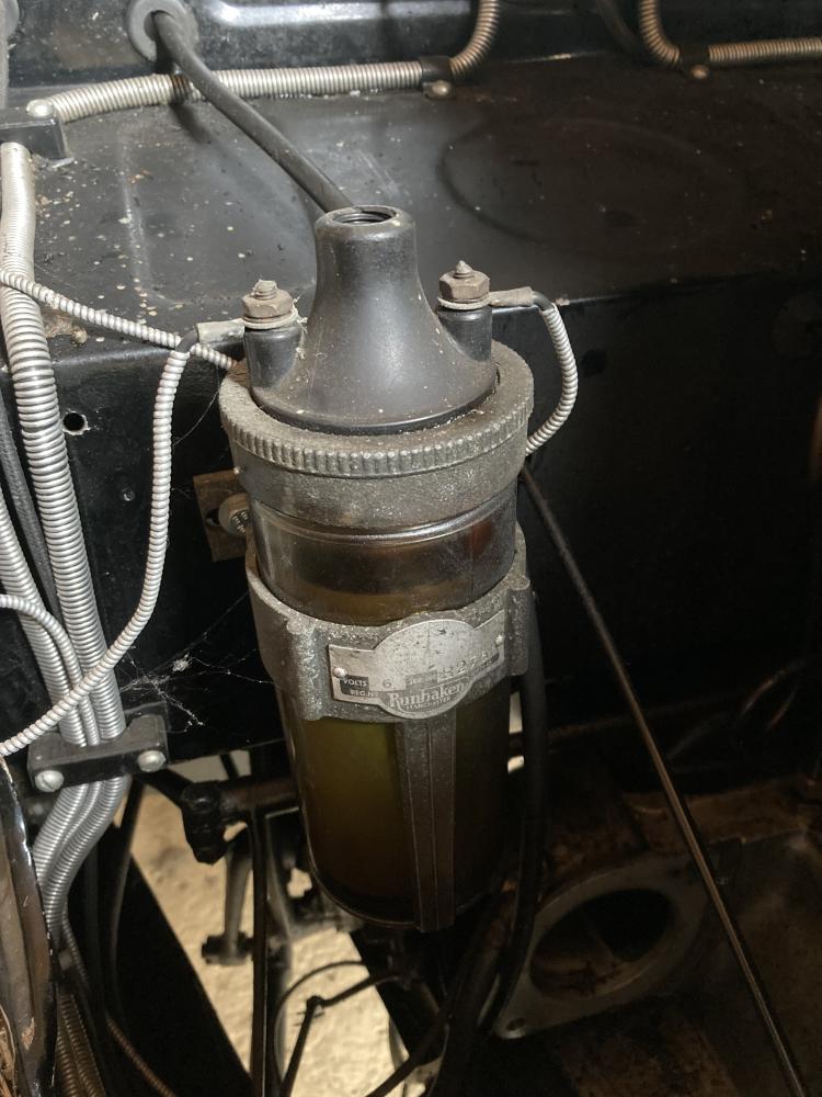

(05-04-2022, 01:05 AM)A G Wood Wrote:
(04-04-2022, 05:24 PM)Martin Baker Wrote: There is a step at the bottom of the thread for the acorn, which would appear to prevent the ignition cable from actually making contact with the coil output. Is this intentional? Is it an air gap? In which case to what purpose? I have always got around this by dropping a small nut in the void.
Anybody got any bright suggestions?
Any chance that they originally came with a unique Runbaken nut (like the Lucas 422792 one the SA12  'red' sports coils used) which has been lost in the mists of time?
I've handled second hand Runbaken coils back in the day but being young and foolish I never paid too much attention to design details.
Also regarding the void, what would be wrong with an insulated spacer on top of the split washer to take up the slack (rather than the other way round like you've done) ?

RE: Runbaken Oil Coils - Martin Baker - 05-04-2022
I was thinking the same as AG Wood, that there was a special Runbaken nut. Love to see a picture, if anybody finds one.
RE: Runbaken Oil Coils - Hugh Barnes - 05-04-2022
Seemingly nothing special here?
Look down the screw hole and you should see what I mean. A shoulder preventing the lead disc making contact.
Ah, I see.. I will look again...
