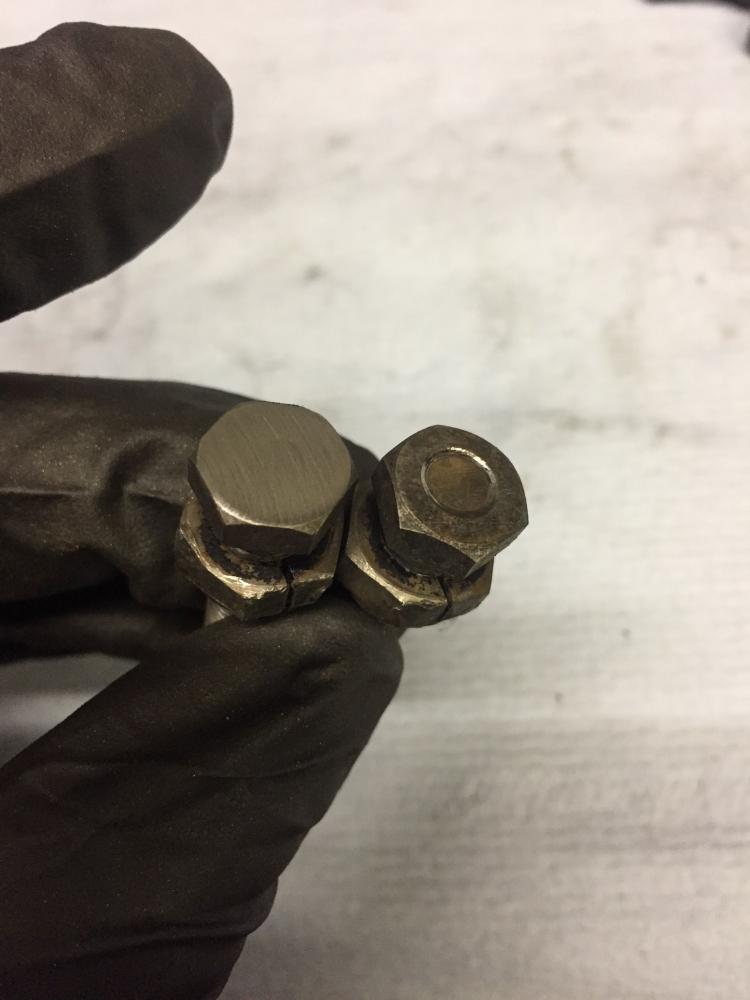

I flatted mine on an oil stone used for sharpening chisels etc.

I'll upset the apple cart, since getting my first Seven in 1962 and a copy of LM Williams Specials book I have always set the tappets at 0.004" cold. After an article on tappet clearances in the PWA7club magazine last year I took one of the Sevens out on a blistering hot day up a long steep hill grinding away in bottom, at the top I quickly stopped and dropped (literally) the tappet cover off and checked the exhaust valve tappet clearances. All were an easy 0.002". Any engine rebuild includes grinding out the wear dimple in the tappet screw. I had to wait a while before I could refit the tappet cover.
