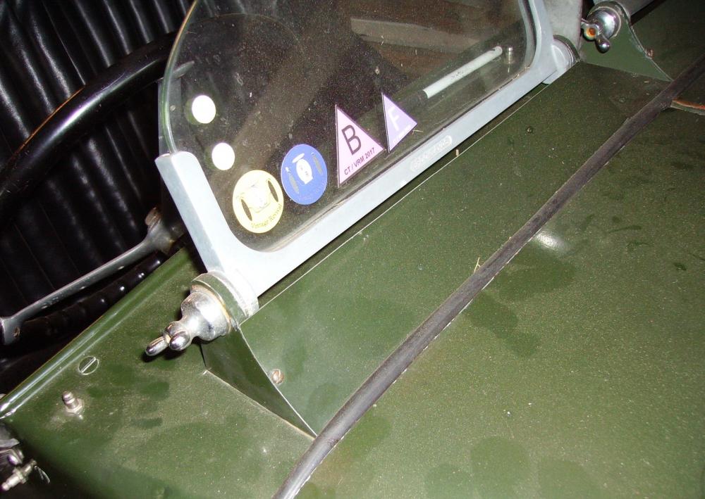

RE: Raising Brooklands aero screen - Robert Leigh - 03-02-2021
This is my solution to avoiding the wind under the screen. The side brackets are made from 6mm aluminium, and can be whatever height you choose to make them. The deflector part is steel on the drivers side (it was on the unfinished car when I got it) and aluminium on the passenger side because it is easier to shape and lighter.
RE: Raising Brooklands aero screen - JonE - 03-02-2021
Thanks both - I can now see that I could adopt the wooden plinth by just making the aluminium bracket plates as per Robert's at each end and then screwing them to the wood.
