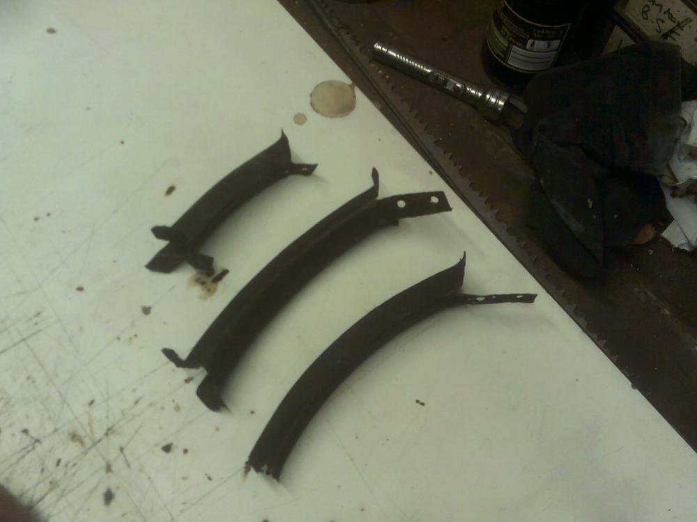

Here's a photo of the latest RN bracket, in total there are three one above the B posts and one central over the rear window. On the RN the side rear window wood frame is like and upside down 'd' with the long leg inside the B post and there is a separate piece of wood over the door, the gutter screws screw into the wood over the door and the top rail of the rear side window frame, note this is an RN I don't know if the RP is the same
RE: 1932 Saloon Restoration - Dave Mann - 12-02-2019
I knew I had some of those brackets somewhere. The rear most gutter fastening is a bolt and nut the rear side window frame top member is too thin for a wood screw, you can just see two holes in the wood one is for a screw to secure the vertical timber to it, the other is for the gutter bolt.
