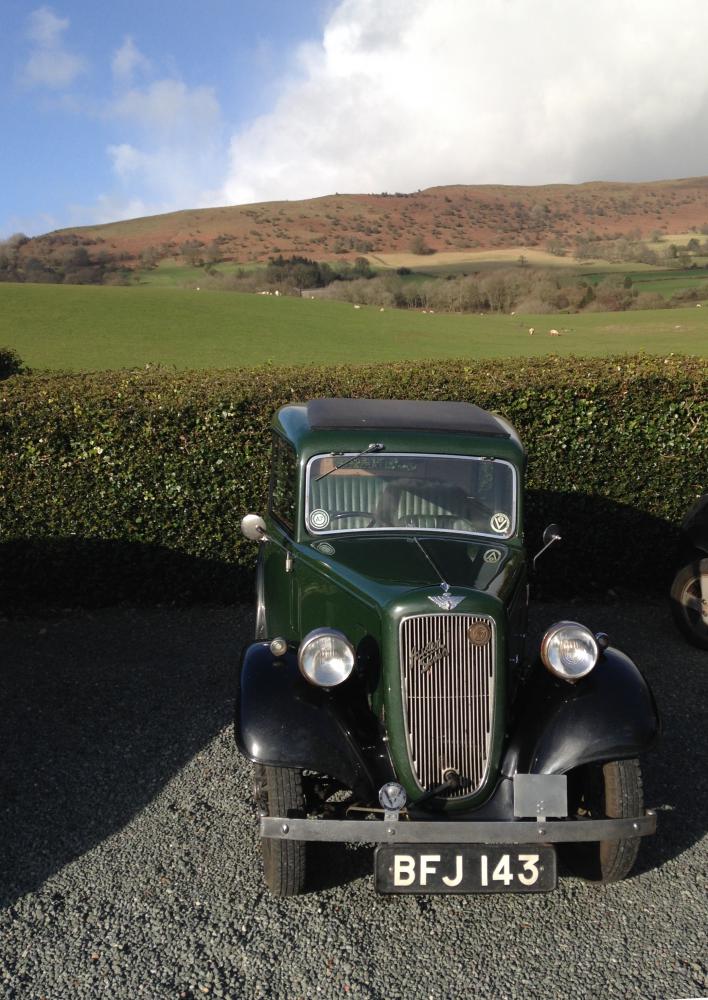

The dear lady wife said that since I had been banned from the Measham by having LEDs which threatened Western civilisation, as observed from the Iron Bunker of Colnbrook, she would instead treat me to lunch. An excellent distraction, though our contributors in North Wales will probably think we drove all the way to Lincolnshire, the flanks of the Skirrid being mere bumps.  Overnight news from a secret location outside Leominster, no-one failed at scruting. No doubt reports or anecdotes of the heroic event in due course.
