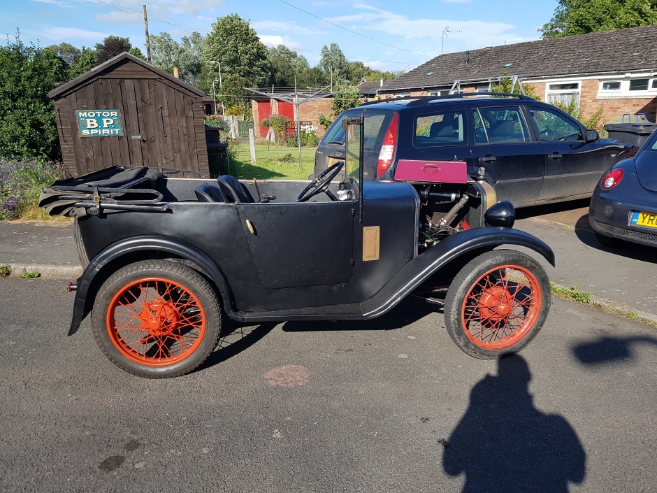

The last couple of evenings I thought id better give two of my sevens some TLC as we are off to Audlem this coming Sunday. One of the only shows I exhibit the cars.
Daughters RP. And my chummy.

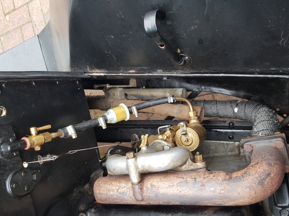

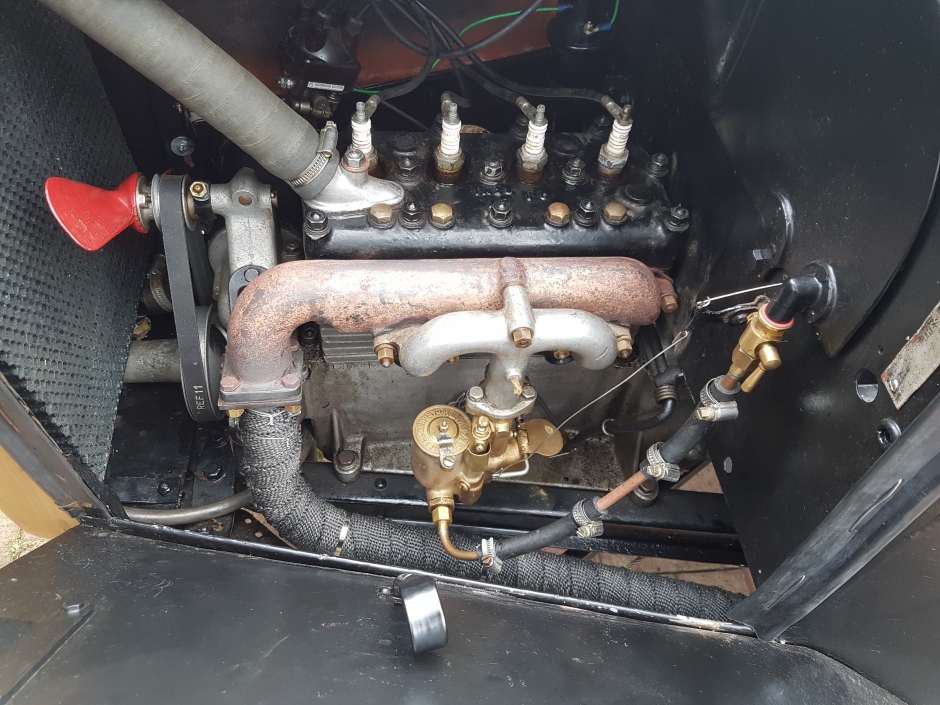

Trouble is my chummy runs superbly, but the swine keeps conking out with no fuel in the bowl. I had wondered about a vapour lock and have wrapped the exhaust, but that didnt help. Nor did removing the filter, nor blowing up the pipe as suggested by the bearded wizzard.
Tonight I put the carb off my grey saloon on it. And its fixed. So thr chummys carb needs a dose of looking at this next week so i can get the grey one back on the road. The rist horn has list its honk so I fixed that, and the drivers side headlamp went limp. So it got a dose of the spanner. I put the fuel filter back on too

    A nice pearl cabriolet for sale at the H & H auction in Buxton yesterday, price range £7500 to £8500, somewhat OTT considering the rather wavy edge to the rear wheel arches. Those in line paper fuel filters are designed for a pressure feed and are not suitable for a gravity feed Hedd. What you need is a glass bowl filter like this Briggs & Stratton one.
RE: What have you done today with your Austin Seven - Hedd_Jones - 26-07-2019
Dave,
I hear what your saying, removing the filter had no effect on the conking out, nor did blowing up what appeared to be a perfectly free flowing fuel pipe.
So I robbed the carb off the grey saloon, fitted it to the chummy (still sans filter), and problem has gone away. I then put the filter back on as there is certainly a little muck in my tank (its visible in the filter). And still no problems. I've since done about 20 mile in fairly short bursts.
I'm off to Audlem in it in Sunday so we shall see.
The problem with the chummys carb is that the engine dies, and when you stop the bowl is empty. If you take the lid off then fuel flows freely. And off you go again. Having had the carb rebuilt with additional (12months later) TLC to the needle I was sure it wasn't the carb. Generally this is during climbing a bank or when driving fast on the open road, generally, but not always, so I thought it was a fuel flow or vapour lock.
As noted the bearded wizard is always a good man for bouncing ideas off. And as a result of a consultation and his suggestion I think the bowl lid, which is not the carbs original may be too tight in the top of the bowl, which means the needle isn't as free as perhaps it should be, and isn't self centring, or is forced in an angle and binds up occasionally. Or perhaps at a certain rev range cos of the vibration, or indeed temperature. At present the lid only fits when in a certain orientation, and requires a deliberate push down to sit properly on the carb body.
I've not done it yet, but I plan to file the lip on the lid so that it is a rattling good fit in the body of the carb, as is the lid on the carb presently fitted, and as are the lids on the other carbs I have in the spares box. I may install the new gubbins on the present lid on one of the spares yet. We shall see how I feel on the day and if I can find my needle files.
