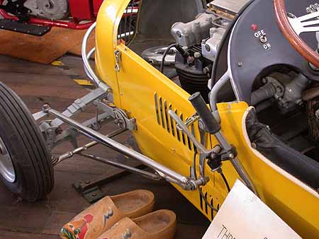

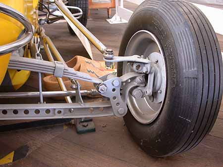

This Australian designed TQ racer of the 1950 uses some Austin Seven components. The most noticeable are the axle, front spring, stub axles and the steering box (look under the steering wheel in the third photograph above). It is interesting to note the fabricated steering arm (see first photograph) used to replace the weaker Austin Seven steering arm. I guess our current concerns are simple revisiting this issue 50 years later!
