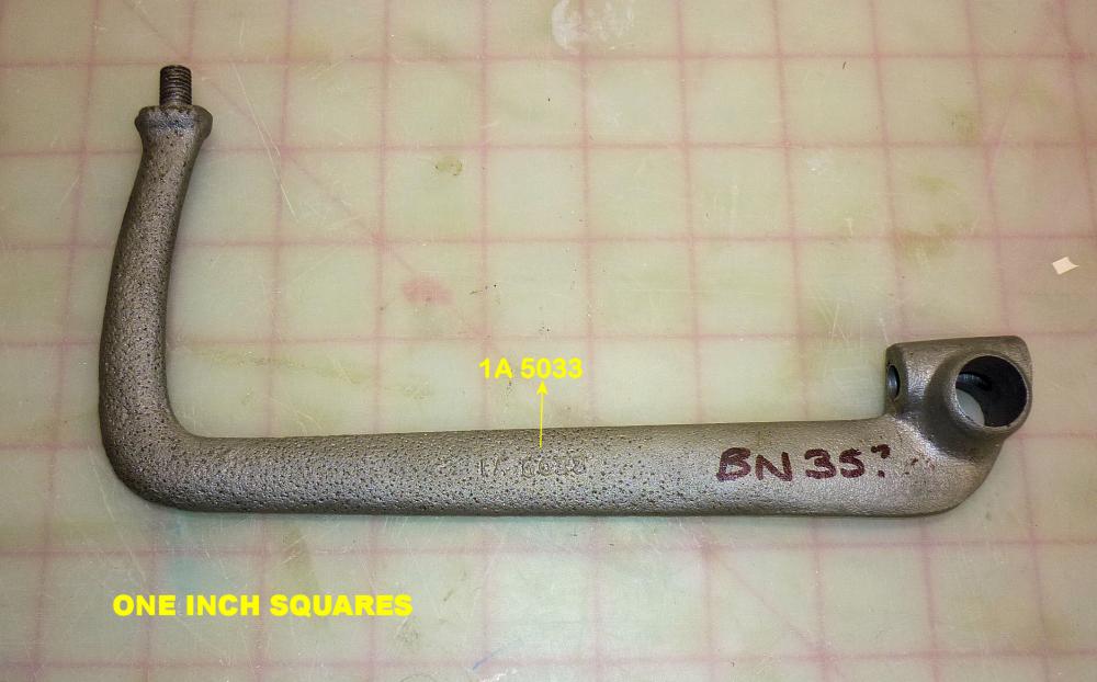

  can any of our experienced members identify this clutch lever as being the correct one for a 1929 AD chassis (engine number M79673)  with a three speed gearbox ?
To me it looks like it is  BN 35 from the illustration in the spares catalog for 1929. Can anyone confirm this please ?

well, it's not adjustable/has positive position on shaft, so thats surely correct for 3 speed...
BN35 is correct for 1929
Ref No  BN35 corresponds with Part No 1A5033 in Publication 1403 --Price of parts (cost 4 shillings and 9 pence)

(10-11-2019, 06:55 PM)Ken Morton Wrote: BN35 is correct for 1929
Ken Morton , North Vancouver, Canada
Thank you Ken, my suspicions are confirmed.
