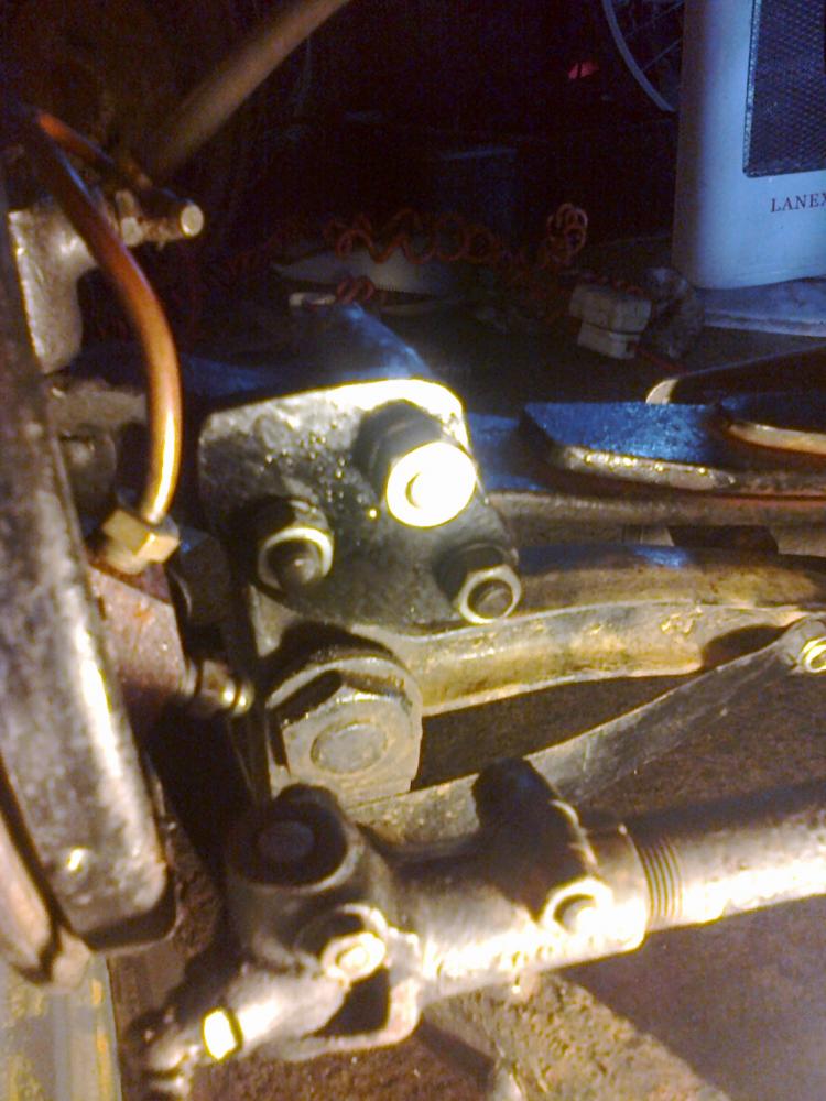

This is one way of immobilizing the spring shackle with a triangle plate.  Terry.

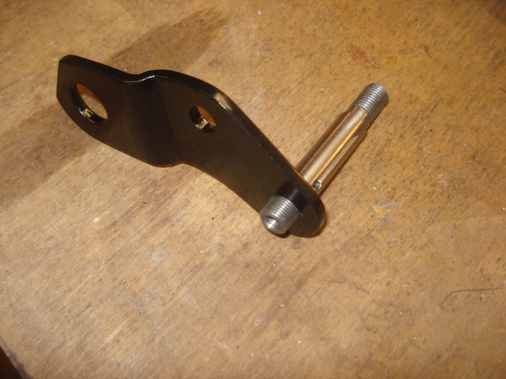

My solution was to make a plate that took the place of one shackle, the pin is turned up from 7/16" steel and threaded into the plate in the same was as you would when refurbishing a shackle, the Joddle allows the plate to fit over the radius arm end and be installed behind the axle so as to retain a std appearance from the front. I machined up a thin wedge to go between the spring and chassis nose casting, and in this case as the radius arm ends are fabricated copies of Nippy/Ulster items I simply altered these slightly to retain the ball in the correct location.

Many thanks Terry and Ian for your engineering expertise. I will give that a go after I've finished with the diff.

In your picture of the spring immobiliser Ian i'm obviously missing something. Are the top and bottom bolts not stationary and the middle one requiring a bush and grease nipple? cheers  Russell
#29
I thought something looked 'off' .
The simple hard rubber block each end centres the assembly and doesn't require a workshop !
#30
That's what I do Tony but the racing fraternity may require more precision ?  cheers  from sunny Qld
