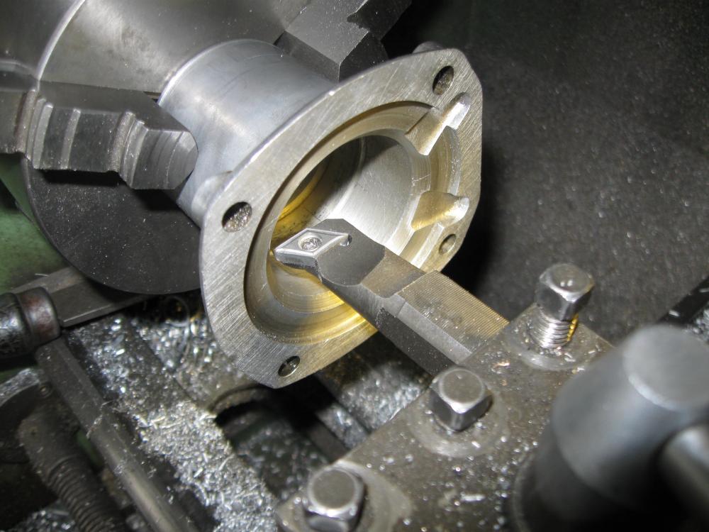

The Cornwall A7 site shows the output,but the crash box has a step in the casting a small seal would be needed.A thrower could be fitted between the speedo gear and output flange with a little machining to the inside does anyone have any thoughts.
On the input end it is fairly straight forward but i would use a larger diameter than the CA7c advises to suit the casting.On this end a V ring thrower could be used inside and a sealed LJ35 bearing with the internal seal removed again any thoughts or ideas appreciated.

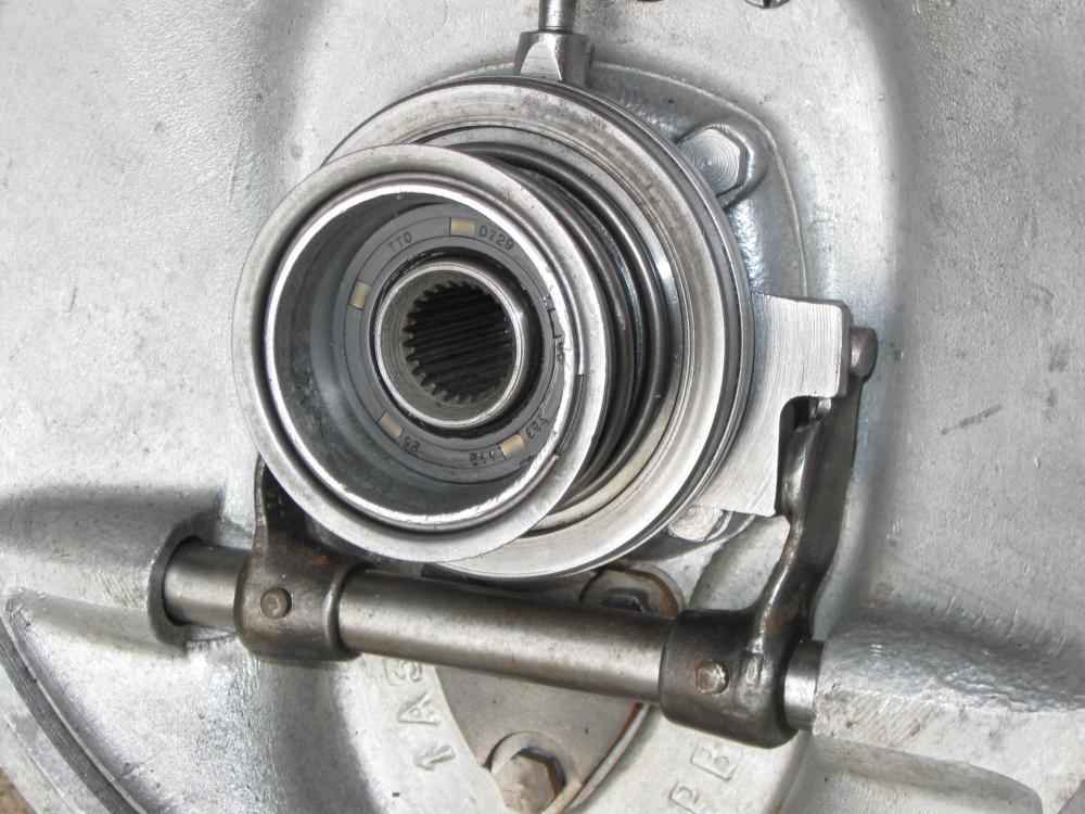

From purchase in 1940 my synchro car was maintained as book and always gave trouble with oil on the clutch. A seal as illustrated was the single most useful mod ever undertaken.
Personally I have run several cars for many years and many thousands of miles with unmodified Synchro boxes and NEVER had issues with oil getting onto the clutch. I believe over filling the gearbox and over zealous lubrication of the release bearing to be the prime culprit of oil on the clutch. I should say that I have completely rebuilt all my gearboxes at the outset so they have been in extremely good condition rather than clapped out which of course may have some bearing on the outcome, if the input shaft flaps around due to worn races it may well leak.
